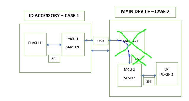

    I am using STM32 in my project. The use case includes the following :-
1) ID accessory(pen drive) ----> STM32.
In this STM32 should act as a USB host and detect the ID accessory as well as do some data transfer. We are going to use MAX3421E which will turn STM32 into USB peripheral . I have library for MAX3421 which I will be including in the code.
github.com/jakakordez/max3421e-stm32/tree/master/Src
My doubt is will I need USB drivers here? If yes which class drivers should I add?
2) The ID accessory will be having a Flash chip with file system mounted on it. It will also have a unique Device ID. The STM32 will have to read that device ID whenever ID accessory is plugged in to the device. The RX and TX of this communication will happen via SPI protocol I assume. In the library I have seen the code for detecting USB and enumerating it. But how to send data to the ID accessory(flash chip) and how to receive data from ID accessory?? I am confused on that.

Actually the block diagram will be of this kind:-
1) ID accessory(Kind of pen drive- not actually a pen drive) ----> NRF52840.
In case 1 STM32 should act as a USB host and detect the ID accessory as well as do some data transfer. So we are using MAX3421e which will support host operations.
Help needed for CASE 1.
STM32 will have to fetch data from the FLASH 2 and send this raw data to MCU 1 via MAX3421.
1)For this which USB stack will be needed is my question?
2)In the library which I shared above I have seen the code for detecting USB and enumerating it. But how to send data to the MCU 1(samd20) and how to receive data from MCU 1(samd20)?? I am confused on that.
3) How will USB drivers in case 1 be used with SPI drivers?
Thanks & Regards,
Snehal
Javier1
Principal
January 30, 2023
As @AScha.3​ said, use the native USB peripheral included in your stm32.
It would be easier and you use one chip less.
If they dont have a very good reason to use MAX3421, they just made your life 100x more difficult, and you look like you dont have a lot of experience already, chances are after a couple of months of pain they end up changing the HW design after you quit.
Trust me on thisone.
Help needed for CASE 1.(this is a STM32 forum, maybe you should ask this question in a mmicrochip forum)
I have never used this MAX3421,beacuse stm32f103 already has USB.
I would bet the SAMD20 should use the (Mass storage device USB profile/stack)
Why dont you ask to the creator of the library?
I never used a SAMD20 , but i do believe MAX3421 is transparent to USB, so no SPI anything in SAMD20.
hit me up in https://www.linkedin.com/in/javiermuñoz/
