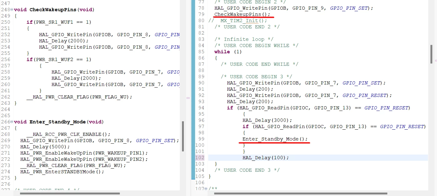

I want to know which Wakeup pin or Reset pin wakes up the microprocessor that enters standby mode. I have 2 wakeup pins.
I am monitoring SR1 and SR2 variables with Live expression in Debug mode, but when I wake up from standby mode, the value of the variables does not change.
Is there a method other than the code block below?
I am grateful in advance.

method you are using is correct, but in masking wakeup flag don´t use PWR_FLAG_WUF1 but PWR_SR1_WUF1 and instead of PWR_FLAG_WUF2 use PWR_SR1_WUF2 and it should work fine.

You can see the coding in the attached image.
When both WKUP pins are woken up, only the LED named GPIO_PIN_8 lights up.
So WUF2 is never HIGH.
GPIO_PIN_8 when woken up with pin 1,
GPIO_PIN_7 should work when woken up with pin 2, but GPIO_PIN_8 works even when I wake it up with pin 2.
