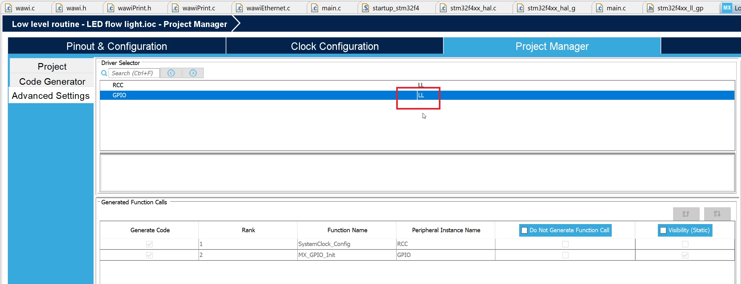

But therefore you need to enable in cubemx the LL functions for GPIO.
