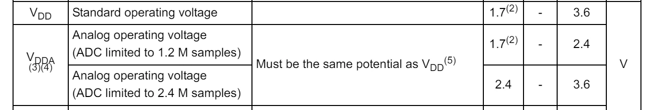

How to read Lipo battery life from a STM32 F427IH6 (Robomaster Development Board)
Hi, I am working with a Robomaster Development Board Type-A https://www.robomaster.com/en-US/products/components/general/development-board
From the picture you see on that website, I plug LiPo into the 24V Power input.
I am trying to do a project in which I get the remaining battery life from the STM32. How would I do this?
From reading the datasheet for the F427IH6, I can see that VDD = VDDA.
However I'm not sure how to read VDDA or VDD.
It seems like the ADC1 pin can read an interval value called Vrefint
Which i gather from research has some linear relationship with VDDA but I don't know what it is.
I would also like to get some clarification on what exactly VDD, VDDA, Vrefint, and other related values mean.
