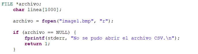

Hi everyone,
I'm trying to open an image as a .csv or .bmp file in STM32CubeIDE. I've already tried different ways of reading the file but none of them would actually work. When I build the project the output gives no errors but when debugging, the file seems to be NULL. Should I add the .csv or .bmp file to the Src folder?
How should I import a .csv format file?
B.t.w, this is the code I wrote to open the file:
Thank you all in advance.

Use semihosting. Please see: https://community.st.com/t5/stm32-mcus/how-to-use-semihosting-with-stm32cubeide-and-stm32/ta-p/49742
Use absolute file paths because relative filenames with the semihosting are relative to the debugger directory, not to the project.

The alternative is to have the file on the Target by way of a Micro SD Card, or USB Flash Drive, and driven by FATFS File System or Microsoft's equivalent.
