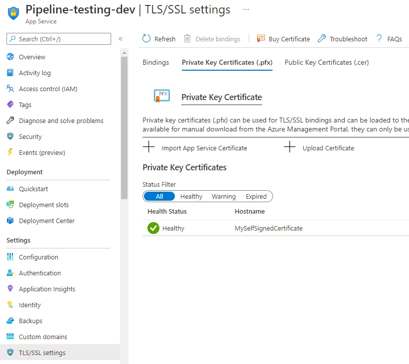

 So, I have a certificate on Azure app service :
0693W00000KaVLgQAN.pngI would like to know how to add it in my code. It seems I have to download it in .pem format but I do not know how to do it.
Thank you
Guillaume K
February 25, 2022
This is confusing. X-CUBE-AZURE purpose is to connect an IoT device to an Azure IoT Hub.
You are talking about an Azure App Service certificate. So it is not the same thing .
Going back to the original problem, what is the exact warning message from Azure ? ("When connecting a device we get security alerts from Azure, telling that we do not use a TLS certificate validation.")
is it written exactly like this ?
I know the root CA certificates from Azure will change soon. Is it this specific problem ?
https://docs.microsoft.com/en-us/azure/security/fundamentals/tls-certificate-changes
https://techcommunity.microsoft.com/t5/internet-of-things-blog/azure-iot-tls-critical-changes-are-almost-here-and-why-you/ba-p/2393169

Guillaume K
February 28, 2022
As far as I understand the problem is not with the certificate itself. It's the software used for TLS communication that doesn't use the certificate.
The security article mentions WolfSSL and OpenSSL. But X-CUBE-AZURE uses mbedTLS. So are you using a modified X-CUBE-AZURE or an entirely different software ?
