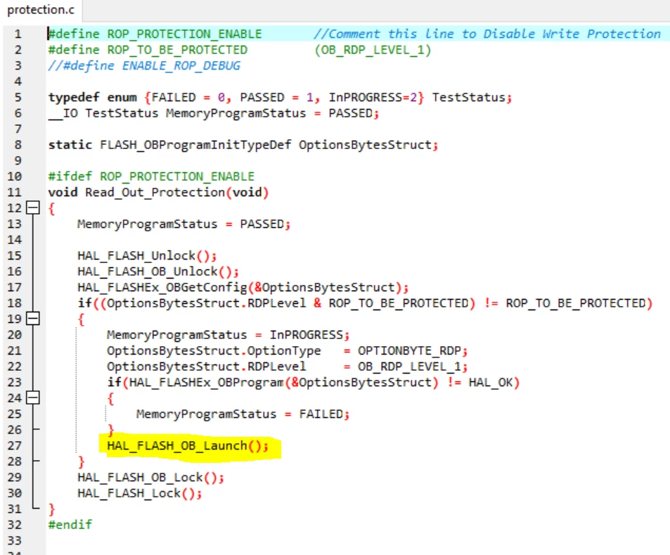

How to modify default option bytes in to STM32 uc using DFU.
I am using DFU to load my application code in to target board, I can be able to convert application build in to dfu build and also be able to load using DfuSe tool in to my target board.
I want to enable the ROP (level-1) in STM32, for that I need to change the default value of option bytes,
Can anyone know how to modify the default value of option bytes for STM32 uC/chip using DFU.

Don't they just exist at a specific address, and you just add a record describing them?
Also, consider having your own code know to lock down the part and do whatever first time initialization/calibration required.

nirav soni
May 10, 2019 2:55 PM UTC
Thanks for the reply,
I have implemented in program, It works the way you have suggested.
Please check the image.
The only question I have is after executing HAL_FLASH_OB_Launch() I am not able to do further debugging.
While debugging the code for the first time once the above mentioned function is executed then I am not able to do further debugging,
Is it because the option bytes are loaded and even then dynamic debugging is not possible.
Please confirm your view.
