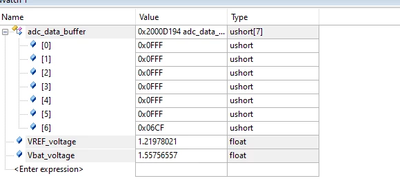

Hi everyone!
I'm having trouble in measuring the VBAT through ADC. I'm using 3.3V on aNUCLEO_476 board to connect to VBAT and when I measure VBAT through ADC,I cannot obtain the value of the VBAT
Here's my code:

waclawek.jan
September 2, 2025
What are the raw readings of VREFINT and VBAT, what is the *VREFINT_ADDR content, and what is the actual voltage measured at VDDA?
You may also read out and check/post content of ADC registers.
esonAuthor
September 3, 2025
Hi JW
*VREFINT_ADDR value is 0x0681,
But there's a really weird thing: when I connect the VBAT pin on the NUECLEOL476 development board to the 3.3V on the board, all of the adc registers value is 0x0000,I don't konw why
And I change some code in my Project:
#define VREFINT_CAL *((__IO uint16_t *)0x1FFF75AA) // VDDA = VREF+ =3.0V(± 10 mV)
float get_VREF(uint16_t adc_value)
 float Vdda = (3.0f * VREFINT_CAL) / adc_value;
 return Vdda;
float get_Vbat(uint16_t adc_value, float vref_voltage)
 float vbat = (vref_voltage / 4095.0f) * adc_value * 3.0f;
 return vbat;

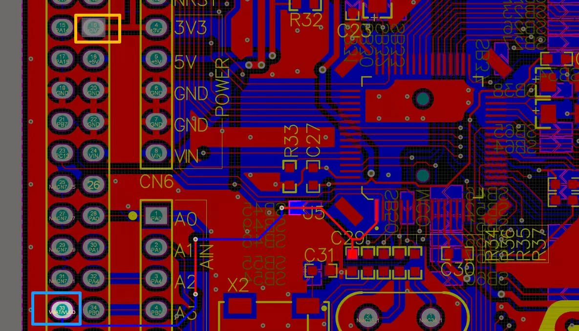

waclawek.jan
September 3, 2025
Isn't VBAT connected to some other circuitry on that board? (I haven't checked).

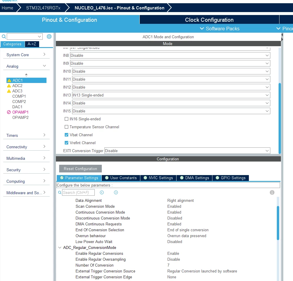

esonAuthor
September 3, 2025
yeah,I connect VBAT with the Onboard 3.3V,and following is mine ADC config
eson

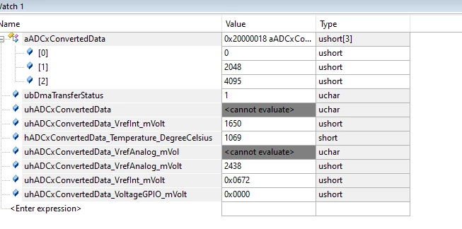

esonAuthor
September 4, 2025
Hello Saket_Om
Thanks for your  suggestion,When I tried to use the program under Projects\NUCLEO-L496ZG\Examples\ADC\ADC_Sequencer, it got stuck in the HAL_Init() function. However, I carried out debugging using the program under Projects\NUCLEO-L476RG\Examples_LL\ADC\ADC_MultiChannelSingleConversion.
I have obtained the following data:
These data seem to have some issues.
I noticed that the VBAT and VDD on my board are connected together and I'm not sure if this affects the VBAT acquisition data.
eson
