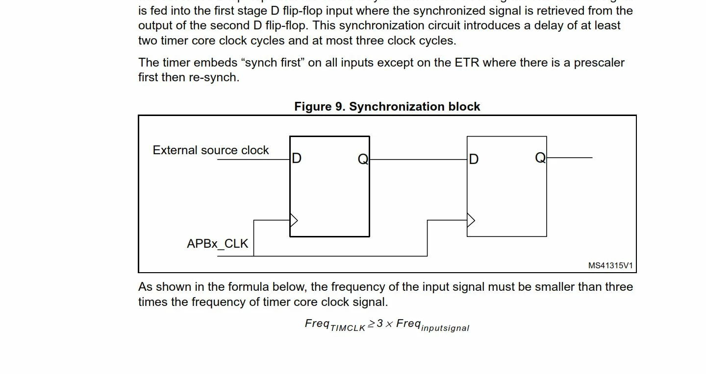

I found a way to measure the frequency. But there are some parts that I can't figure out the difference between.
First is that I found that when using capture input mode after a capture occurs the CCR register is loaded with the content f the CNT.So what are external clock mode 1 (with TI input) and external clock mode 2 (with ETR input)?

Jun 7, 2018 7:13 PM UTC
Posted on June 07, 2018 at 19:13
The external clock makes CNT increment/decrement rather than the APBx clock source.
As I recall the clock routing allows for CH1 (TI1FP1),CH2 (TI2FP2) or ETR as a source
Arman Ilmak
Senior
Jun 7, 2018 11:06 PM UTC
Posted on June 07, 2018 at 23:06
You mean it counts the input signals' edge defined by the software?
If it is a clock that used rather than APBx clock source, why it must be synchronized first?
And when we use ETR and when TI?
