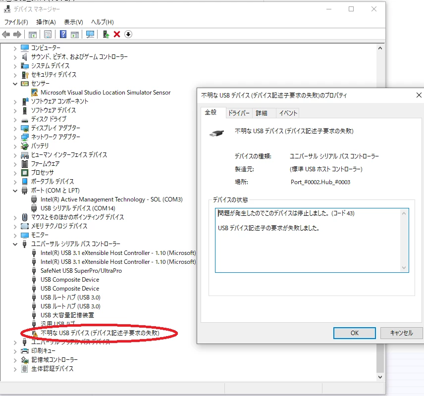

How to make Windows10 recognize USB of Nucleo-144? I want to CDC Communication. Windwos10 recognize ST-Link. But, VCP isn't recognized. I installed the following App. VCP_V1.5.0_Setup_W8_x64_64bits.exe dpinst_amd64.exe

Do you have a CDC program loaded onto the device? Which board?

I'm using STM32 F767 Nucleo-144.
After your advice, I set the initial setting of USB through the CubeMx.​
Then, the usb recognization looks like the attachment.
=>Unknown usb device device descriptor request failure.
I heard that someone doesn't need VCP driver for Windows 10, so I'm uninstalling it.
