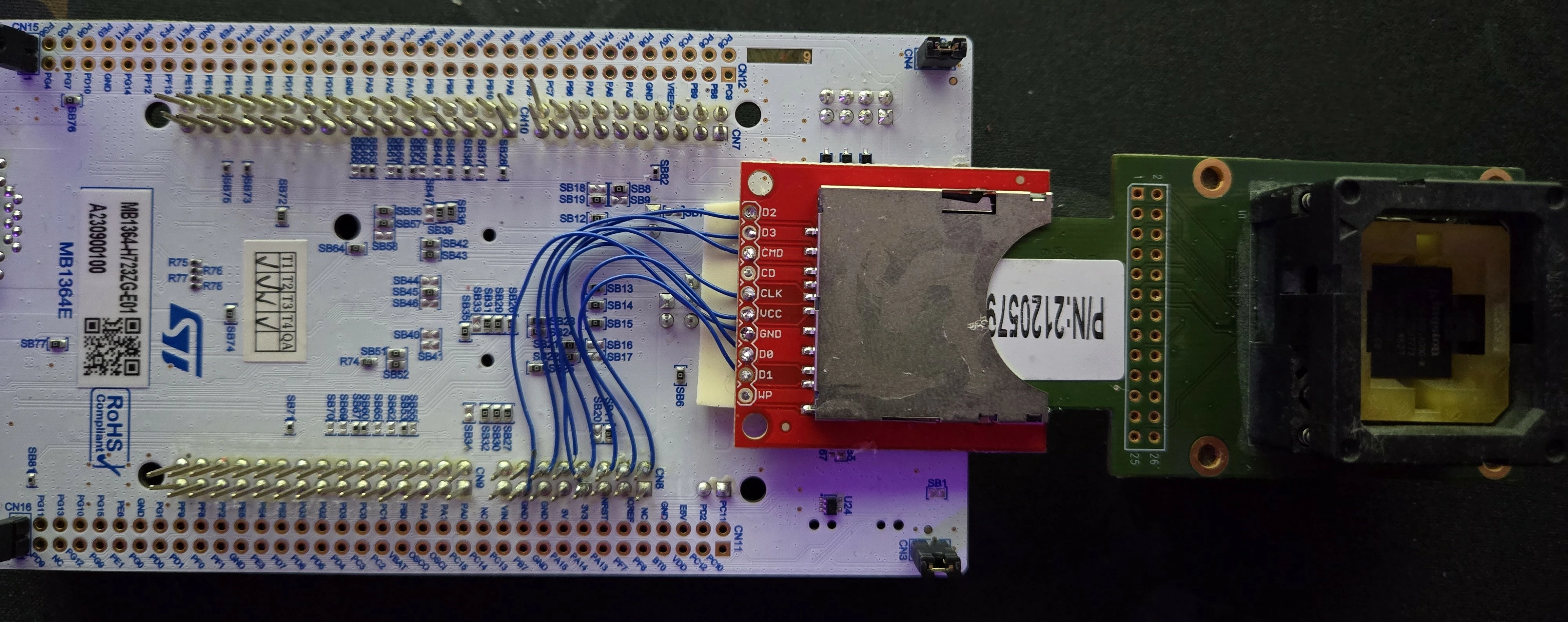

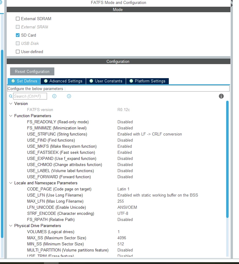

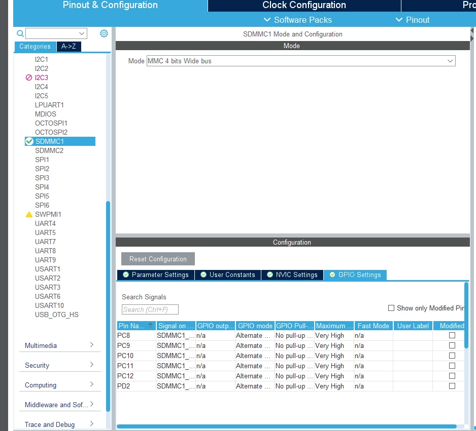

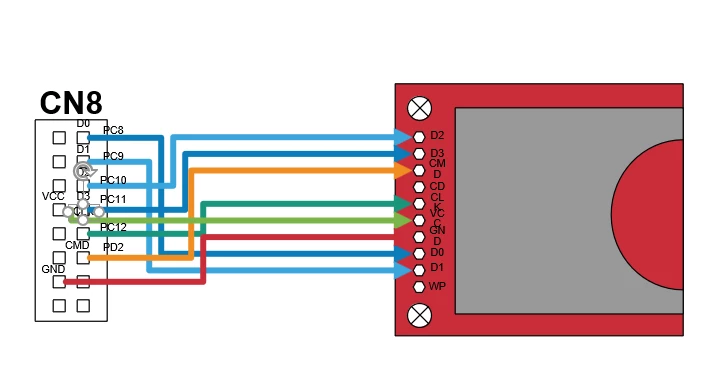

I am utilizing the following components:
  • Nucleo-H723ZH (STM32H723)
  • eMMC: 4GB
I have already created the following files:
  • user_discio.c
  • user_discio.h
  • eMMC_Driver.c
  • eMMC_Driver.h
After connecting an SD card reader to the CN8 connector on the Nucleo STM32H723 board and using an eMMC card reader, the FATFs system is reporting that the eMMC is not ready. I am encountering problems when performing operations like f_mkfs or f_mount, receiving a "Not ready" error. Despite numerous checks of the configurations and parameters, I have not been able to resolve this issue.

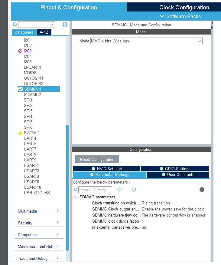

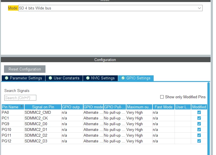

try first SD 1 it first and see if it works
there was problem with CubeMX
the reason CubeMX code generation cannot configure SDMMC and the FatFS at the same time.
this is why it did not work but worked on 1 PIN (SD 1 bit)
if this is the case you can try to work around first initializing 1 bit (in user code) then 4
static void MX_SDMMC2_SD_Init(void)
/* USER CODE BEGIN SDMMC2_Init 0 */
hsd2.Instance = SDMMC2;
hsd2.Init.ClockEdge = SDMMC_CLOCK_EDGE_RISING;
hsd2.Init.ClockPowerSave = SDMMC_CLOCK_POWER_SAVE_DISABLE;
hsd2.Init.BusWide = SDMMC_BUS_WIDE_1B;
/* USER CODE END SDMMC2_Init 0 */
/* USER CODE BEGIN SDMMC2_Init 1 */
/* USER CODE END SDMMC2_Init 1 */
hsd2.Init.BusWide = SDMMC_BUS_WIDE_4B;
hsd2.Init.HardwareFlowControl = SDMMC_HARDWARE_FLOW_CONTROL_DISABLE;
hsd2.Init.ClockDiv = 0;
/* USER CODE BEGIN SDMMC2_Init 2 */
/* USER CODE END SDMMC2_Init 2 */

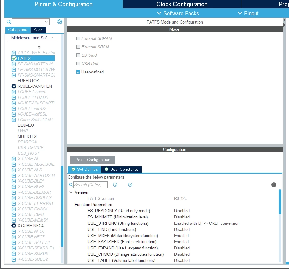

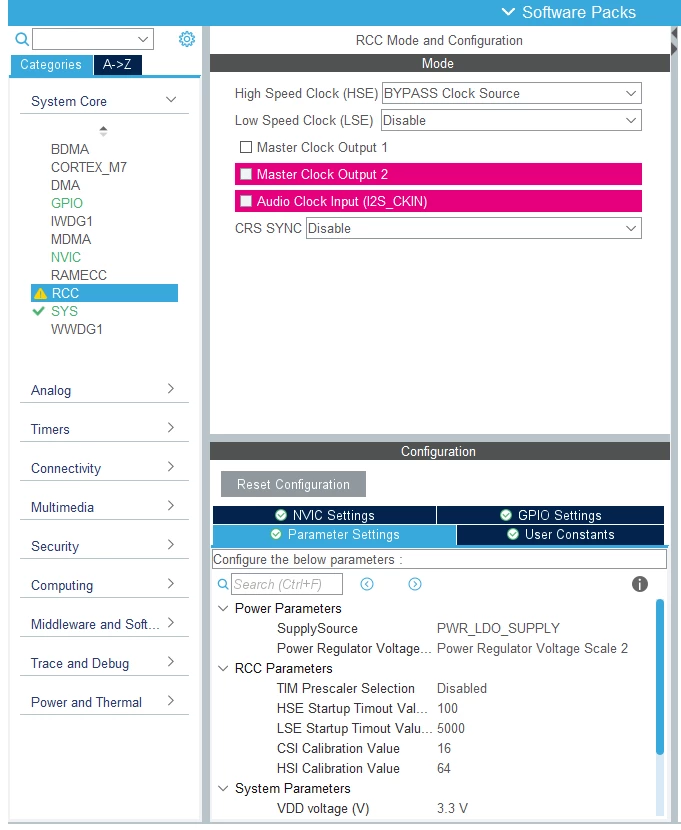

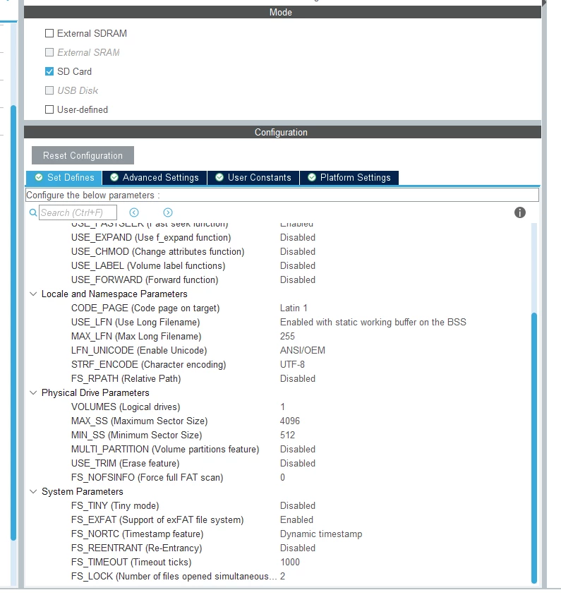

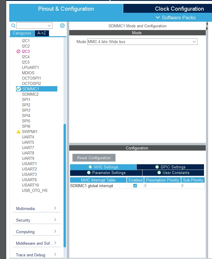

I have tried all your recommendations for the Nucleo-H723ZH (STM32H723), but the FATFs system consistently reports that the eMMC is not ready. I also purchased the Discovery board STM32H735IGK6. When I use the provided examples for a micro SD card, it works, but when I reconfigure it with Cube-MX for an eMMC and follow all the recommendations you mentioned, I encounter a new issue: the FATFs system reports that the FR_INVALID_DRIVE.

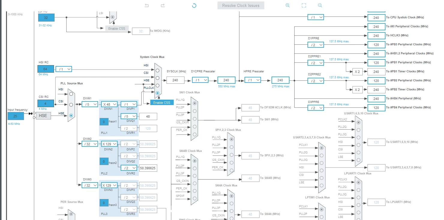

go with SD not MMC
probably something wrong with your settings, some SD cards will not work
I have the same setting on a few boards, all is working
what is your clock in CubeMX for SD ? on my cards it works up to 48 MHz, stops above
