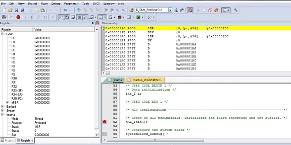

Hi, clivel, I just did some test. If I keep default address settings, the debugging works normal. However, when I change IROM1 to 0x80E000 and size to 0x20000 (128K), the debugging failed to jump to main entry. I captured the screen and you can see almost all debugging buttons are greyed out. Any idea why and how to solve it?
LR_IROM1 0x080E0000 0x00020000  {    ; load region size_region
  ER_IROM1 0x080E0000 0x00020000  {  ; load address = execution address
   *.o (RESET, +First)
   *(InRoot$$Sections)
   .ANY (+RO)
  RW_IRAM1 0x20000000 0x00020000  {  ; RW data
   .ANY (+RW +ZI)
Tesla DeLorean
Guru
Jan 13, 2015 5:31 AM UTC
Posted on January 13, 2015 at 06:31
Yes, you'd need code, or vector entries, at the base of the flash to transfer control to new location.
From the debugger perspective you could assign SP and PC to the appropriate values you could get these from the vectors at the base of your image. You code in SystemInit() would also want to set the vector table address (SCB->VTOR) to point to the new base address.

From the post ''How to program the application flash file (hex file) in chosen flash area by using ST-LINK for STM32F0'' and ''Need advices for separating flash memory for STM32F0 and STM32F1'', I understand the code placement is the job of linker. In the linker setting of Keil project, I check ''Use memory layout from Target Dialog''. So other than this, do I need to manually add code to any source file? If yes, would you please advise how to do it?

And you've probably changed the address in the linker, check the .MAP file to confirm the placement.
The linker address doesn't magically change the silicon in the processor. It does very specific things when it starts, and unless you have to code or table to direct execution to your new location it's not going to go there.
Suggest you brush up on you microprocessor basics, with perhaps one of Joseph Yiu's Cortex-Mx books, and the concepts of compilers, linkers and loaders.
Review the IAP examples which provide a Loader + Application model, where the application code is placed at a higher address.

I think I understand the concepts and what I should do, my question is how to do it. I already went through  the example code with AN3965. This example program still starts from 0x08000000 and it can perform a jump to user code that starts from 0x08004000, but the problem I had is that the program can't even reach main entry if it is located at the customized address. I have tried Keil's configuration for IROM1, linker memory layout, flash download memory and changed VECT_TAB_OFFSET in SystemInit(), but none of them works. So when the MCU can't find the main entry, I can't use code in main() to change table address or jump, as the example does. That only leaves me Keil target setup and linker configurations, or maybe bootload handling which I currently don't know much. So I really need some advice about HOW to solve the problem.
