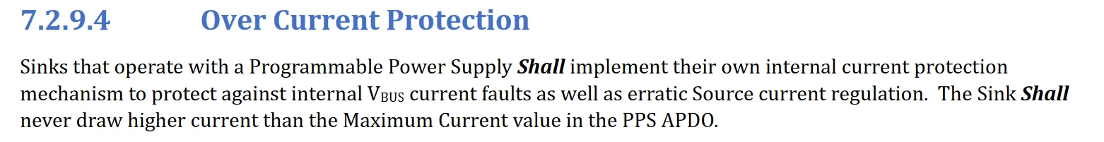

I am making a PPS (sink) application based on NucleoG0B1RE + SNK1M1. As noted in various resources, the TCPP01-M12 doesn't include OCP protection. However, the USB Power Delivery Specification R3.2 on usb.org, strongly recommends OCP protection for sink operating with PPS.

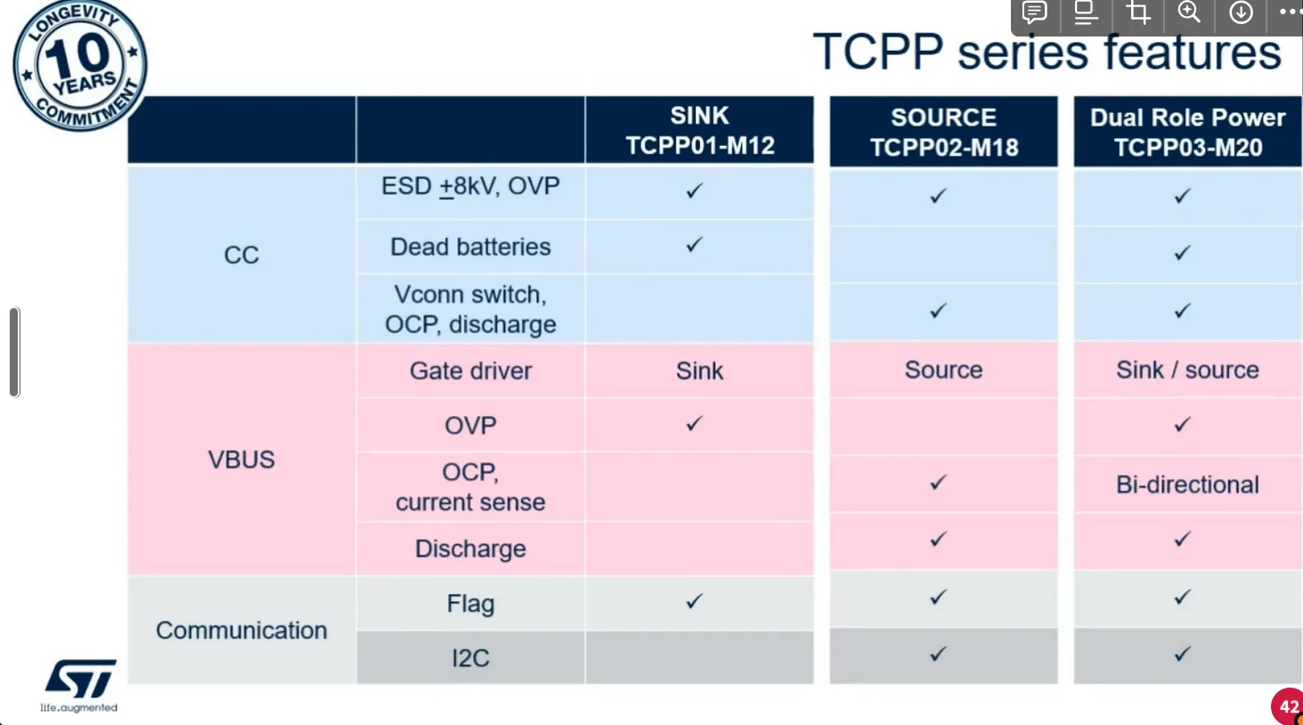

Using, external OCP (high side amplifier + comparator) will be more expensive (and complicated) than on the shelf integrated solution.
Both solutions can drive VBUS load switch (MOSFET used to activate VBUS)  to perform OCP.
Use TCPP03-M20 for SINK with OCP is the best path forward.

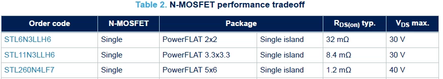

You can use STL11N3LLH6 or any single N-MOSFET as only connector to provider voltage needs to be managed by MOSFET.

TCPP01-M12 has been tailored to optimize cost then it embeds only key protections for SINK (OVP on VBUS / CC + ESD).
When VBUS OCP is needed, TCPP03-M20 can perform SINK only solution with OCP feature. It is the recommended solution.
TCPP03-M20 embeds an OCP based on shunt resistor (Rs) voltage (OCP trigger = 47mV). The Rs value provides current threshold.

If I move to the TCPP03-M20, what MOSFET to choose: Can I continue using the STL11N3LLH6 MOSFET for my sink-only application, or is it necessary to use the dual STL40DN3LLH5 (source-to-source configuration), as seen on the DRP1M1 shield?
