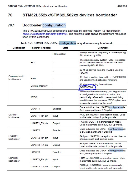

But apparently that piece of code is not working on STM32L552. Actually by looking into aplication note (AN2606) in "table 153. STM32L552xx/562xx configuration in system memory boot mode" in system memory row it isn't stated that system memory contains the bootloader firmware.

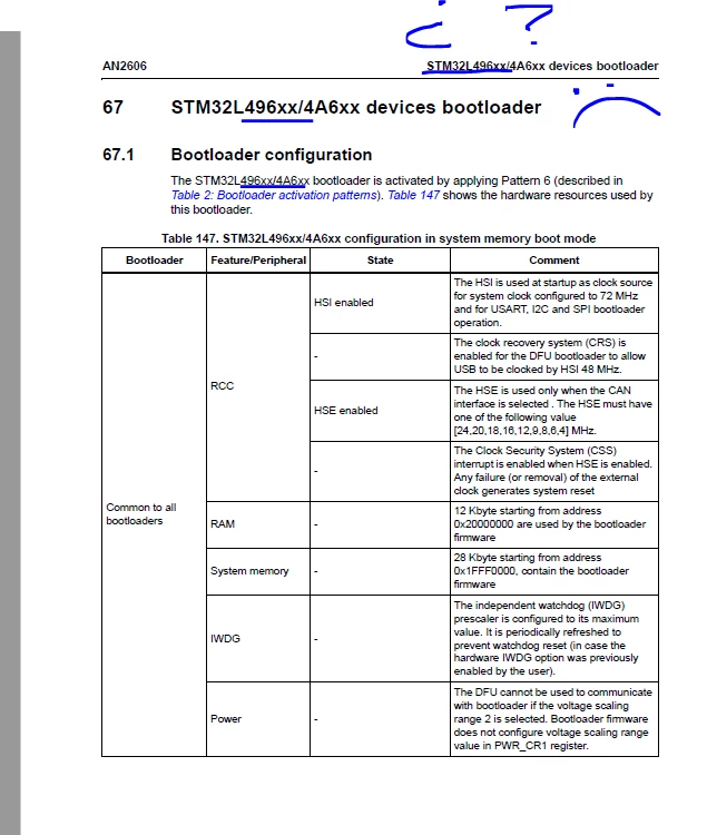

table 147 is not the table for your microcontroller!, maaybe you have an outdated AN2606 version? mine is february 20230693W00000aIP48QAG.png
Is this what youre looking for?

My bad. Mine is actually up to date too. I wrote the wrong table number. I'll fix it.
And if you look at the system memory row. It doesn't state that it contains bootloader firmware.

Its work without remap . just call this function :
void JumpToBootloader(void) { void (*SysMemBootJump)(void); volatile uint32_t addr = 0x0BF90000; // ADDRES FOR SYSTEM BOOTLOADER HAL_RCC_DeInit(); SysTick->CTRL = 0; SysTick->LOAD = 0; SysTick->VAL = 0; __disable_irq(); SysMemBootJump = (void (*)(void)) (*((uint32_t *)(addr + 4))); __set_MSP(*(uint32_t *)addr); SysMemBootJump();  }
