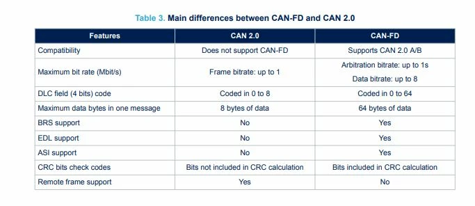

Apr 13, 2021 1:05 PM UTC
Hello @TOlli​ ,
Thanks for reporting the mistake in the AN2606.
You are right, in the STM32H7 figures 57-58-59, the return loop from "USB cable detected" goes back to UART condition, but it should go back to FD-CAN condition instead.
The update of the AN2606 is on-going (Rev48) and it will be published in a few days.
The FDCAN and CAN protocols are totally different. You can refer to the AN5348 FDCAN peripheral on STM32 devices:
0693W000008zPAUQA2.jpgNote that the ST-link V3 supports CAN bootloader and does not support FDCAN.
So, you should implement a host software that supports FDCAN.
