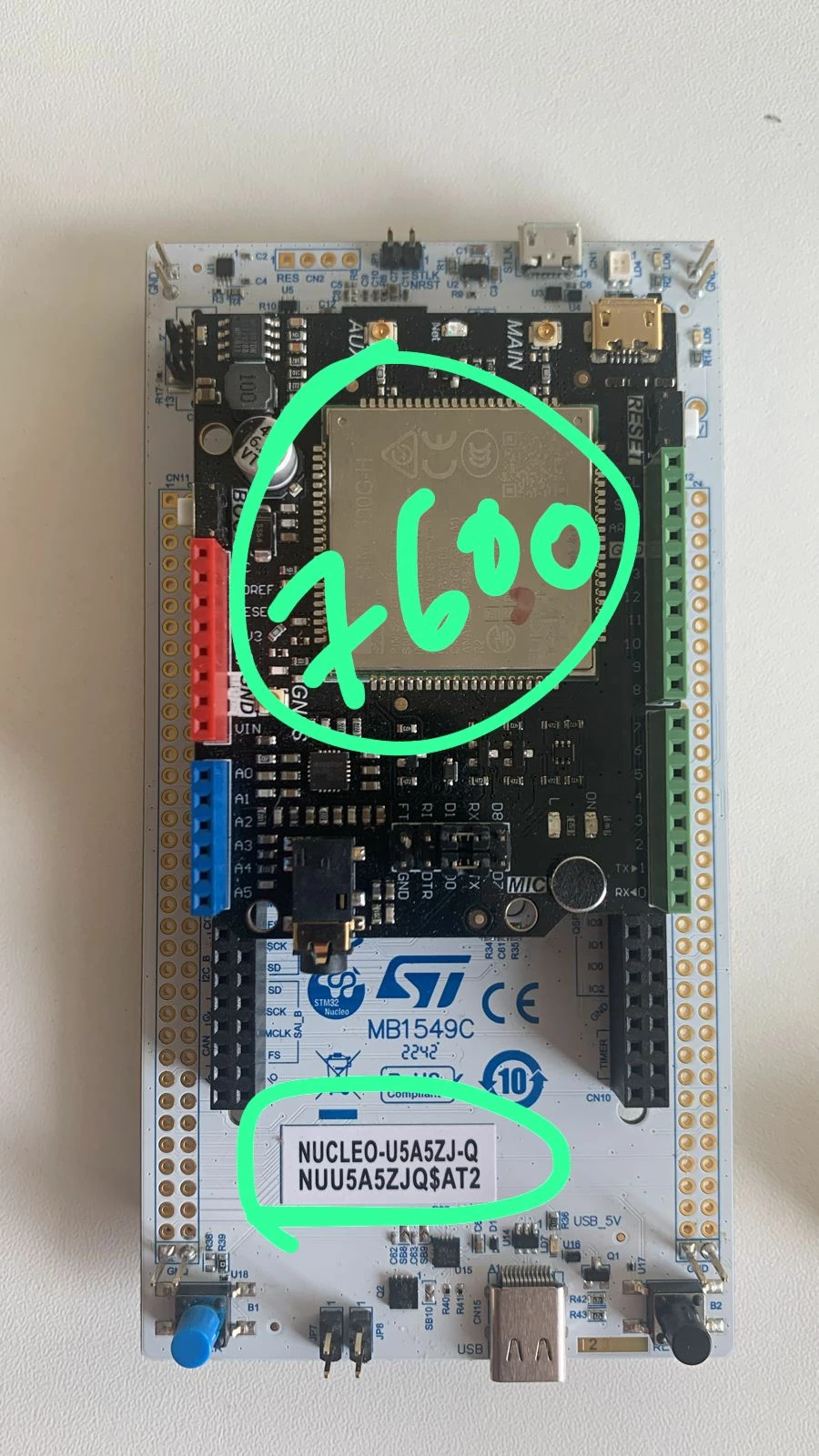

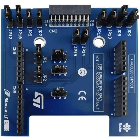

Could you please confirm whether it is possible to integrate Xcube cellular with my Nucleo STM32U5A5ZJTxQ board?

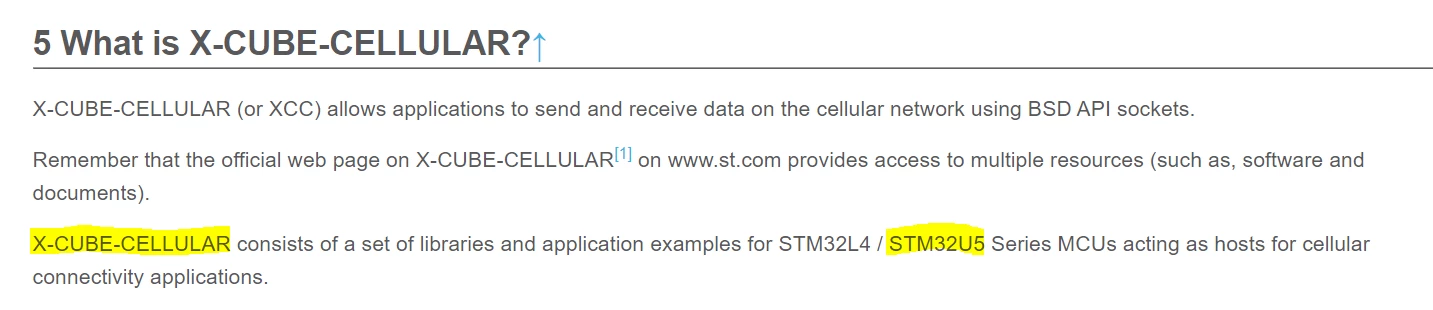

From the documentation of Xcube Cellular, I can see that "X-CUBE-CELLULAR consists of a set of libraries and application examples for STM32L4 / STM32U5 Series MCUs acting as hosts for cellular connectivity applications."

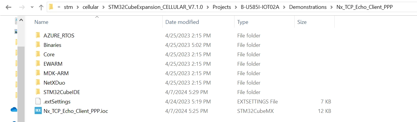

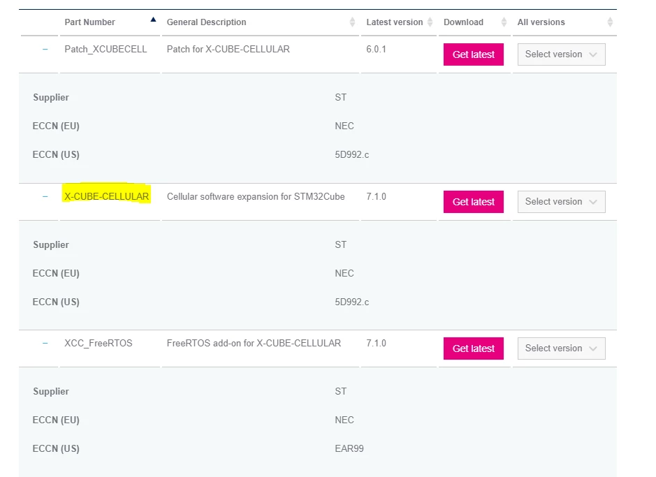

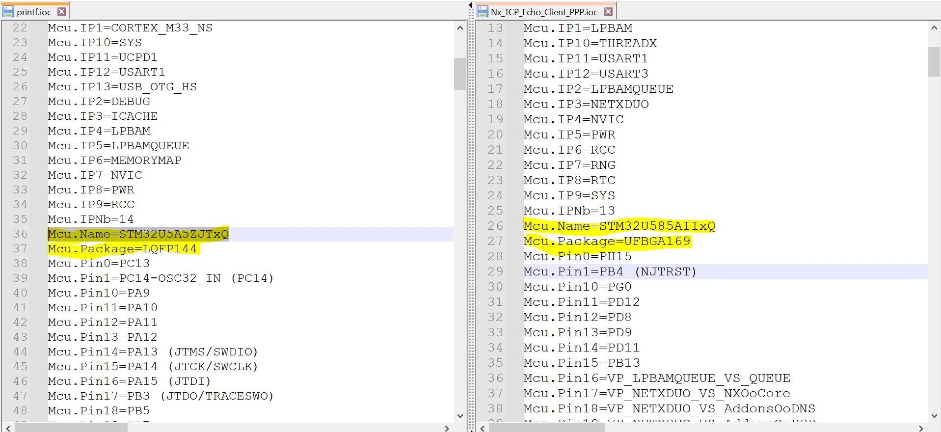

I have downloaded the Celluar package and found one example for PPP. But how can I port this application into the STM32U5A5ZJTxQ?
Pavel A.
Apr 7, 2024 5:32 PM UTC
Hi @srikanthpalvai  From the X-CUBE-CELLULAR description, you need STMod+ adapter to connect the cellular device to the Nucleo.
The software supports STM32U5 family, and, per the description, LCD or external memories are not required  So it should be possible to run it on this Nucleo.
For further steps please see the ST wiki: Cellular:Cellular X-CUBE-CELLULAR F.A.Q. - stm32mcu

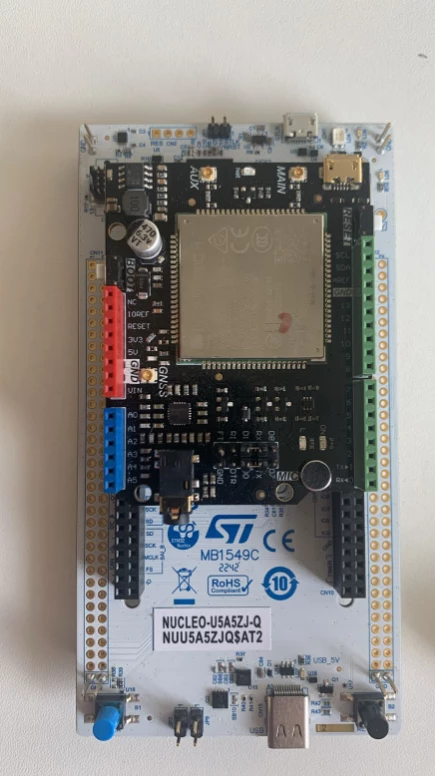

@Pavel A.
I believe I can utilize it directly without the need for the STMod+ adapter, as the SIM7600 is designed as a HAT for the Nucleo board.
However, I'm interested in understanding if the X-CUBE-CELLULAR package includes a custom modem interface section or any specific provisions that would allow me to integrate my SIM7600 module without having to modify the entire cellular code base. Essentially, I'm looking for a way to seamlessly incorporate my modem into the existing framework without significant modifications.

Thank you for clarifying the situation. So, to consider the hardware side covered, it remains only to check that the "HAT" interface pins match the Nucleo (UART pins go to UART, power to power, ground to ground... etc).
If you have already powered it up and no smoke come from it, likely they do match ))
Now try the basic communication between STM32 and the modem: send some AT commands over the UART and receive replies. No need to use any special libraries at this step. Just the UART or two and GPIOs.
