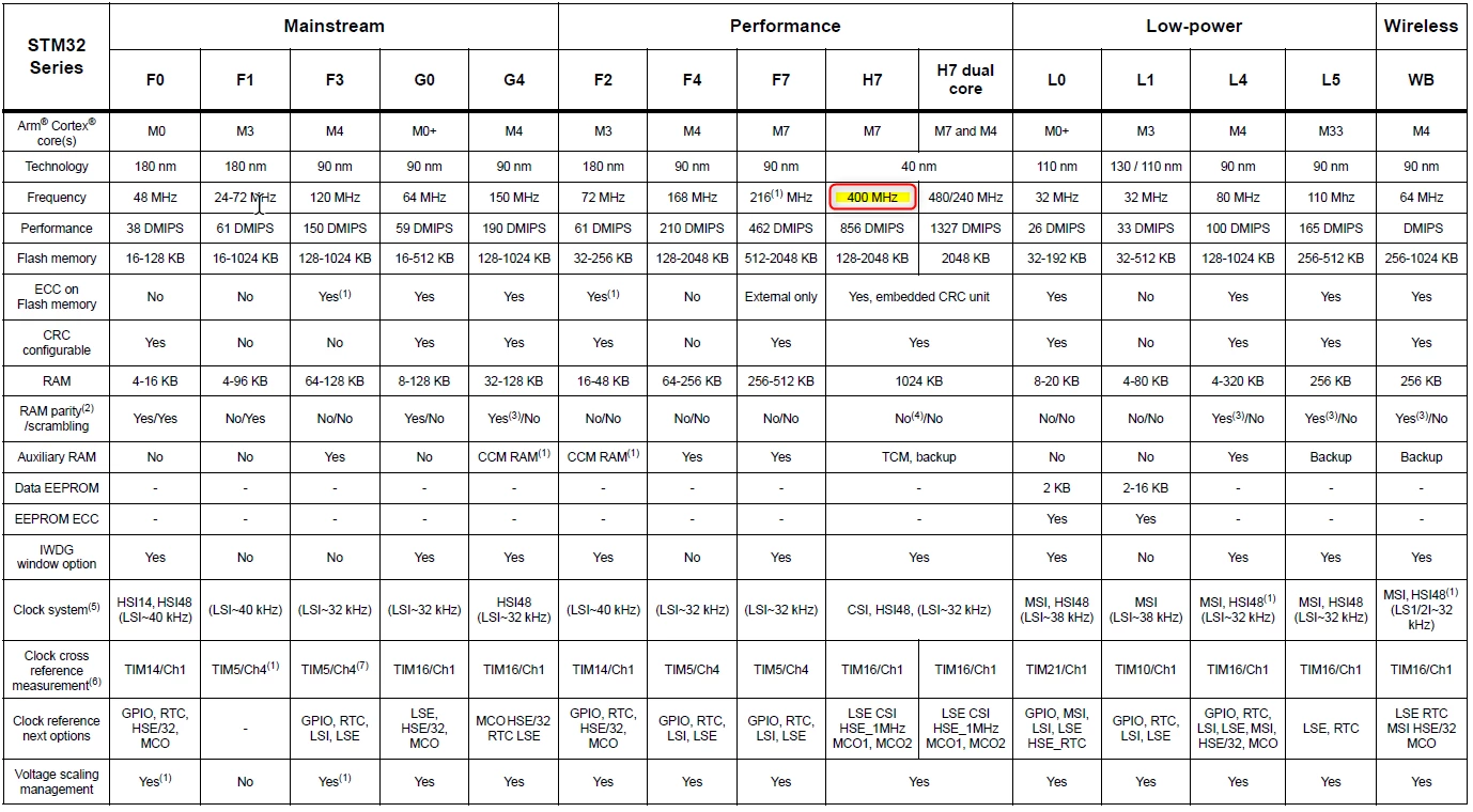

Q: Is there any reason for choosing 400MHz?
Please find the attached image referring toAN4435.

This indication is related to the STM32H743/753 series. The first revisions of this device were limited to 400MHz. From the revision V, a boost to 480MHz has been possible at certain conditions.
For the Dual core STM32H7, this 480MHz boost mode has existed from the beginning. That's why the table indicates 480/240 MHz => M7/M4.
This table is up to date in accordance with the STM32H7 series used for certification (STM32H743I_EVAL board in the case of STM32H7 mono-core).
But for the STM32H723, this information should be 550MHz. There no particular clock limitation due to X-CUBE-CLASSB.
I will forward this remark on the table for update in one of the next revision.
