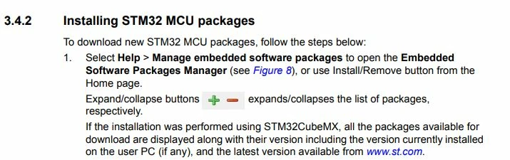

Feb 26, 2021 3:52 PM UTC
Hello @MQi.1​ ,
You can download the STM32CubeL5 MCU package from STM32CubeMX (integrated with STM32CubeIDE tool) in command-line mode, or using user interface.
You can follow the instruction in the UM1718:
Please mark my answer as best by clicking on the "Select as Best" button if it fully solved your issue. This will help other users find this solution more quickly.
Imen
