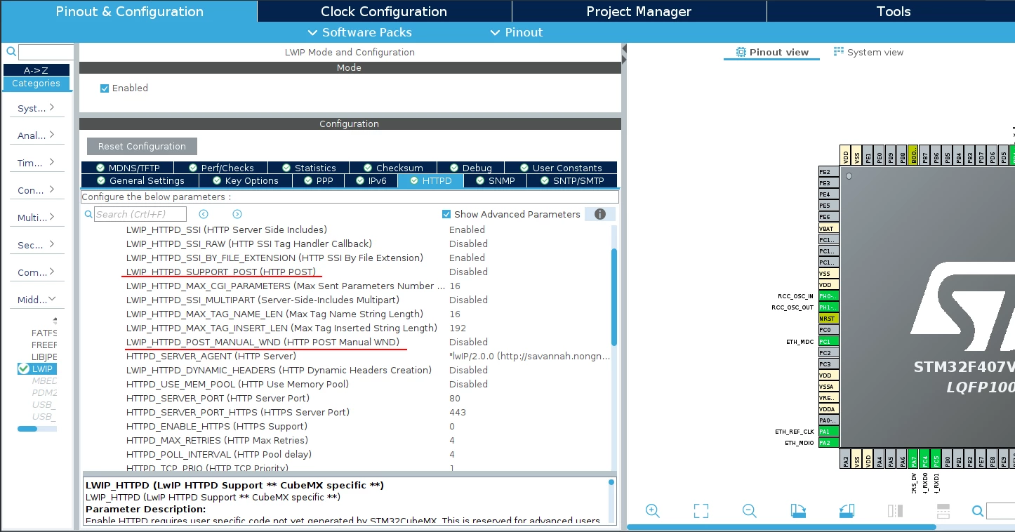

This is not STM32-specific? see screen...

STM32 specific would mean the thing is made by ST for STM32 and is not usable on other platforms. On the contrary lwIP is an open source library available to anyone and is used on myriad of platforms.
Read this topic:
https://community.st.com/s/question/0D53W00000A3jV8SAJ/questions-about-lwip-post-operation
