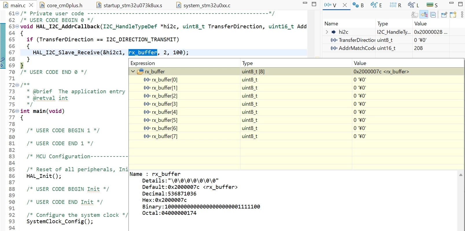

How to implement I2C communication between two STM32s.
I'm implementing I2C communication using an STM32WBA2 as the Master and an STM32U0 as the Slave.

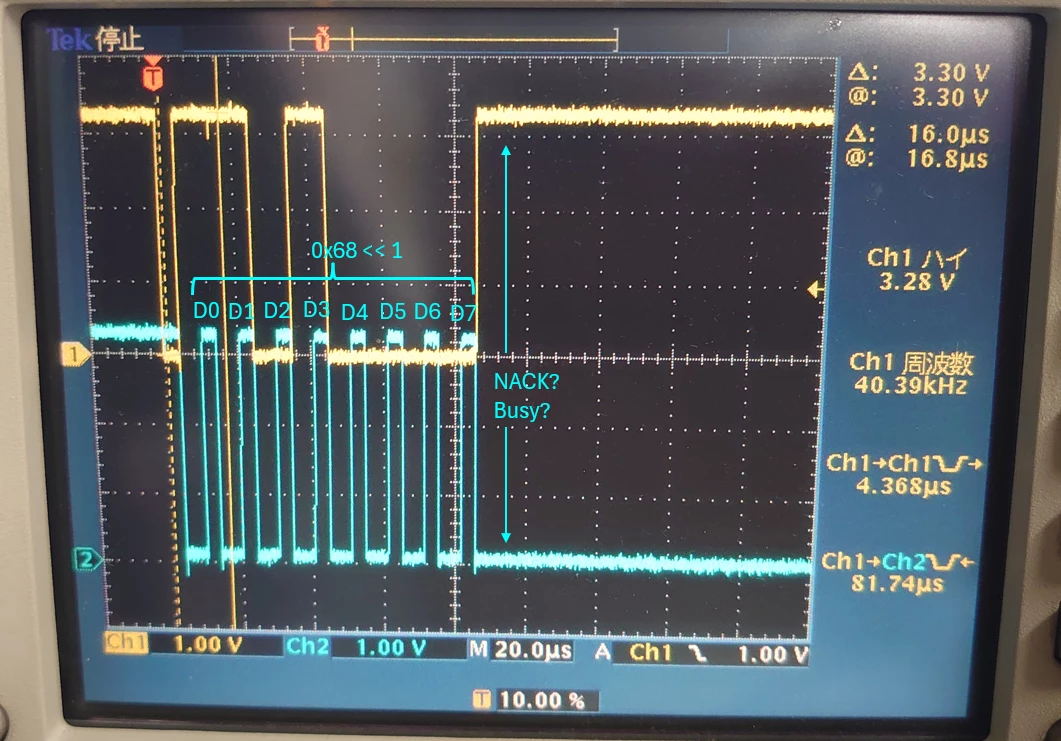

I've implemented a process to send one byte of data (0x75) from the Master to the Slave, with the Slave Address set to 0x68. However, when I check the SCL/SDA waveforms, it appears there's no ACK from the Slave.
On the other hand, the Slave receives an event in HAL_I2C_AddrCallback() when it receives 0x68, but the value read by HAL_I2C_Slave_Receive() is empty.
How can I receive 0x75 from the Master?
I've attached the main.c files for both the Master and Slave.

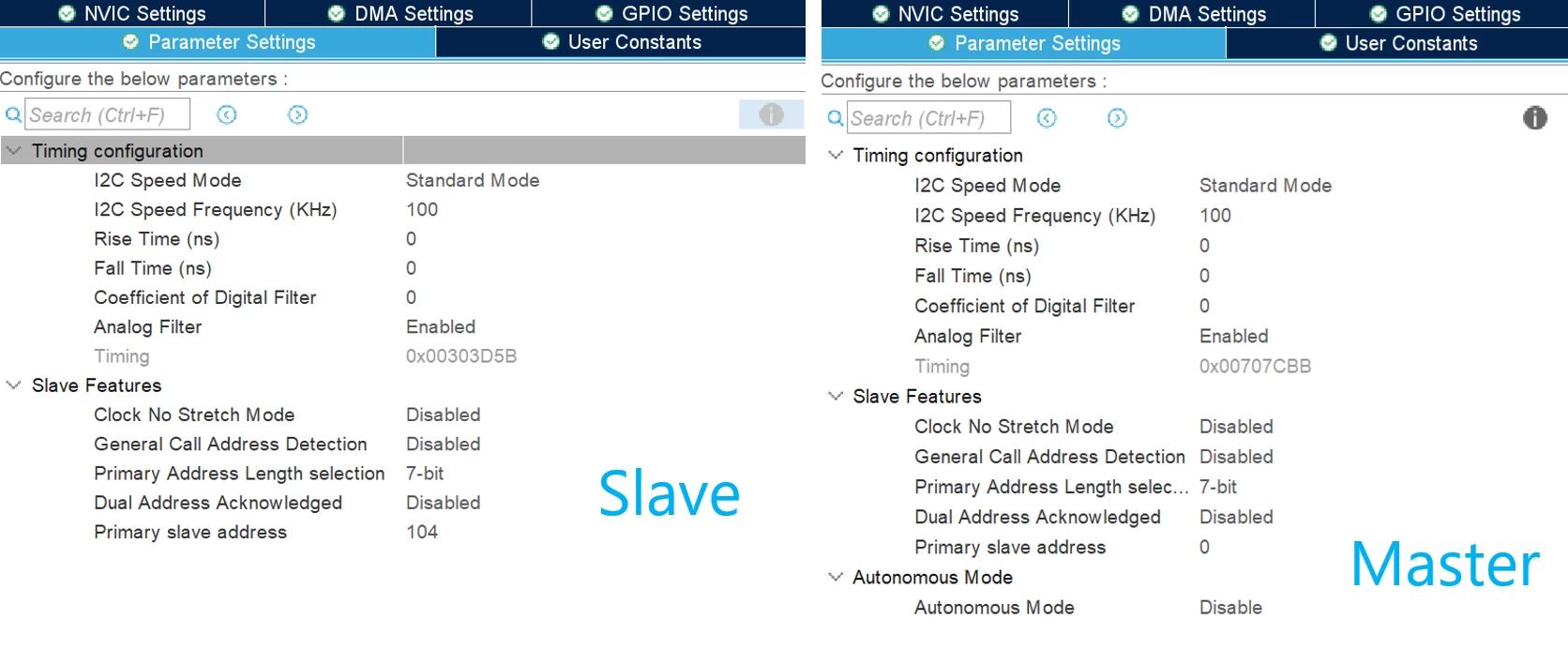

The CubeMX configuration is as follows:

Try to find some example Slave code with a more complete ..._AddrCallback().
+1
​@gocchan The Cube firmware packs for both STM32WBA and STM32U0 have examples of doing I2C between two boards:
https://github.com/STMicroelectronics/STM32CubeU0/tree/main/Projects/NUCLEO-U031R8/Examples/I2C/I2C_TwoBoards_ComIT
https://github.com/STMicroelectronics/STM32CubeWBA/tree/main/Projects/NUCLEO-WBA25CE1/Examples/I2C/I2C_TwoBoards_ComIT
You should be able to access these direct from CubeMX.

The flat line on the clock indicates the Slave is holding it low until the code indicates it should ACK the address.  Try to find some example Slave code with a more complete ..._AddrCallback().

So slave clock stretching is enabled.
Check what the RM says about when this is done.
In the L07x I’m currently working with I have the ADDR interrupt activated, so the clock stretching ends and the correct address is ACK’d when clearing the ADDR interrupt flag, Check if this happens somewhere in your code.
			/* clear ADDRESS match flag
* -> this ends CLOCK STRETCHING
I2C1->ICR |= I2C_ICR_ADDRCF;
