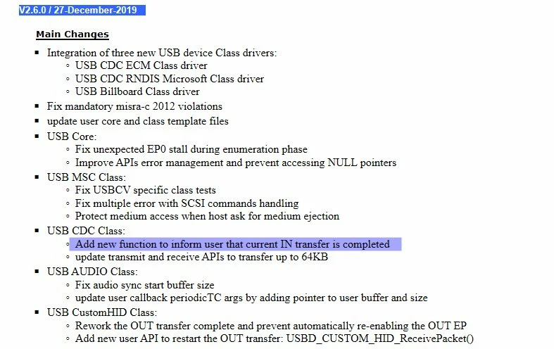

Yes, the F3 firmware pack uses an old version of the USB device library (2.5.3) from April 2019.
This callback was added in 2.6.0 December 2019.
You can try to simply replace the library (or even just the CDC library files your project uses) with a newer version (from the G4 firmware pack for example) and work through the compiler errors, if any. Maybe you'll get lucky.

You are right. The code generated for the F3 does not include this callback (It is present in code generated for G4).  I'll try and track down how the callback is called in the G4 code, to see if there's a reason why the F3 doesn't include such a callback (perhaps it's just an older version of library)
