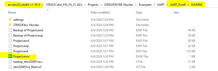

The example project is called UART_Printf. Here is a screen shot of the directory
This example code can be found here: https://www.st.com/en/embedded-software/stm32cubef4.html
The example code seems to run fine except the printf() output goes to the Terminal I/O window in the IDE. Not out the UART or Virtual USB com port.

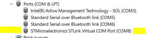

I want printf() to send data out USART2. And if it did,  think I would also see the data on the Virtual USB Com Port too. In device manager I do get this:
So that is a good sign.

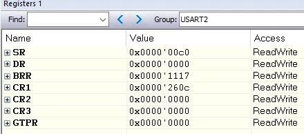

And I do see that USART2 has been configured:
But when I run the code, the Data Register on USART2 is never written to. I set a break point on a data write to 0x04000'4404 (the DR register) and it never gets written to. I also put a scope on the USART_TX signal (pin 16, PA2 of the MCU) and it is not active.

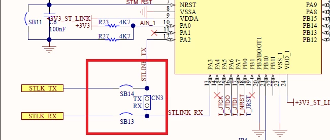

What about the pins you have configured for USART2: are they PA2 (Tx) and PA3 (Rx)?
Check your HW:
CN3 jumper should be off.
SB13 should be soldered.
3 replies
