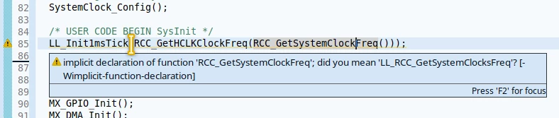

How to get HCLK for LL_Init1msTick?
Hi
I noticed on my STM32G071.. that the "LL_mDelay(1000)" function did not produce a steady 1000ms delay if I vary the HCLK frequency (code generated by CubeIDE)...
I did not have this problem with other MCUs code generated, it worked out of the box (F103/F407).
Then I stumbled upon the "LL_Init1msTick(uint32_t HCLKFrequency)" function which seemed to have solved my problem.
But what is the proper (dynamic) way to get the HCLK frequency for the function?
I currently use this in my main.c:
 /* USER CODE BEGIN SysInit */
 LL_Init1msTick(RCC_GetHCLKClockFreq(RCC_GetSystemClockFreq()));
 /* USER CODE END SysInit */
This seems to pass a valid HCLK to the function. But CubeIDE tells me a warning that:
../Core/Src/main.c: In function 'main':
../Core/Src/main.c:85:18: warning: implicit declaration of function 'RCC_GetHCLKClockFreq'; did you mean 'LL_RCC_GetCECClockFreq'? [-Wimplicit-function-declaration]
../Core/Src/main.c:85:39: warning: implicit declaration of function 'RCC_GetSystemClockFreq'; did you mean 'LL_RCC_GetSystemClocksFreq'? [-Wimplicit-function-declaration]
0693W000005AevWQAS.pngWhats the problem here?

The proper LL way is to call LL_RCC_GetSystemClocksFreq and use the HCLK value it returns. RCC_GetHCLKClockFreq is a private function, for whatever reason.
You could also just put the function declaration for RCC_GetHCLKClockFreq in your header and use it directly, but using a private function is probably not the proper way.

Thanks, already figured it out :)
 LL_RCC_ClocksTypeDef RCC_CLOCKS;
 LL_RCC_GetSystemClocksFreq(&RCC_CLOCKS);
 LL_Init1msTick(RCC_CLOCKS.HCLK_Frequency);
