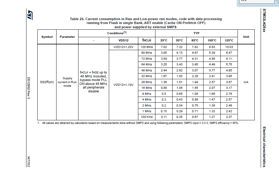

I am using STM32L4q52gt6P controller. for application development, I am using freeRTOS.
When no task running in RTOS at that time I put the controller in sleep mode from the idea task of RTOS.
I have used 12Mhz of HSE, 16Mhz-SYSCLK with PLLCK, AHB Prescaler -1, HCLK 16Mhz, and most of the GPIO are used.
Also, I am using external SMPS for VDD1V2.
My MCU current Consumption is around 3.24mA in run mode and 1.2mA in Sleep mode.
I have added a snap of the datasheet STM32_RUN_MODE
0693W00000Y8kX9QAJ.pngI want MCU current consumption as per mentioned for fHCLK 16Mhz in the datasheet.
Anyone, please suggest to me what thing I need to set to achieve 0.88 mA current of CPU?
What are the steps I need to take care to achieve this or where I need to debug or which additional HAL API needs to config 0.88 mA current of CPU?
Your response will be highly appreciable to me
2 replies
January 20, 2023
Hello @BGajj.1​ ,
Did you set all free pins as analog ? as it helps reducing the consumption
Please check this article
Hope that helps!

Hello @Sarra.S​,
Thanks for you response!
20 GPIO pins out of 144 pins I am not using. And yea I have keep those 20 pins as analog.
Is it okay to just keep those pins as analog or i need to disable the clock for those pins?
