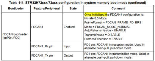

  • I think the system is maybe entering the boot mode because the SP is updating to a value around 01FF12xxx in the function ASYSTR_jump_to_bootloader
  • FDCAN bit rates are reflecting different from what is mentioned in the documentation
  • Documentation: bit rates = 0.5Mbps
  • Implementation: Nominal bit rate = 0.25Mbps / Data bit rate = 1Mbps
Questions:
  1. It was unclear whether the FDCAN peripheral needs to be configured as per the documentation or is already configured when the system enters boot mode?
  2. The bit parameters and the resultant bit rates of the boot mode FDCAN configuration is not matching. Could it be a documentation fault? If so, what are the correct values?

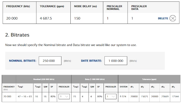

  • AN2606 says 500k, AN5405 says 250k/1M
  • stopping the core while running the bootloader confirms 250k/1M based on 20MHz clock
  • verified PD0/1 are set up for AF9 (also PH13/14, but those pins don't exist on my package)

from my other post here , the steps I took to get responses from the bootloader:
# configure the CANFD driver on Linux:
sudo ip link set can0 up type can bitrate 250000 sample-point 0.75 sjw 16 dbitrate 1000000 dsample-point 0.75 dsjw 4 fd on
# monitor the CAN bus (in a different window/tab):
candump -tdex can0
# send a standard (11-bit) CANFD frame with BRS set, ID=000 and a 64-byte payload:
cansend can0 000##100000000000000000000000000000000000000000000000000000000000000000000000000000000000000000000000000000000000000000000000000000000
# it is important to note in the command above the double-hash (##) which tells cansend that this
# will be a CANFD packet, and then the single '1' before the 64-byte payload which sets the Bit
# Rate Switch (BRS) switch in the outgoing packet.
# observe the CAN traffic in the candump window:
(179.707038) can0 000 [64] 00 00 00 00 00 00 00 00 00 00 00 00 00 00 00 00 00 00 00 00 00 00 00 00 00 00 00 00 00 00 00 00 00 00 00 00 00 00 00 00 00 00 00 00 00 00 00 00 00 00 00 00 00 00 00 00 00 00 00 00 00 00 00 00
(000.001531) can0 000 [01] 79
(000.000025) can0 000 [01] 0B
(000.000009) can0 000 [01] 11
(000.000009) can0 000 [01] 00
(000.000007) can0 000 [01] 01
(000.000008) can0 000 [01] 02
(000.000008) can0 000 [01] 11
(000.000008) can0 000 [01] 21
(000.000008) can0 000 [01] 31
(000.000999) can0 000 [01] 44
(000.000012) can0 000 [01] 63
(000.000006) can0 000 [01] 73
(000.000005) can0 000 [01] 82
(000.000006) can0 000 [01] 92
(000.000006) can0 000 [01] 79
 It is definitely 250k/1M, and I am suspecting that the sample window/jump settings are important (I have not yet tried without them explicitly set). I am also using the flag value of 1 which should set the Bit Rate Switch flag on the outgoing CAN frame.
