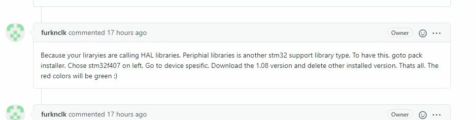

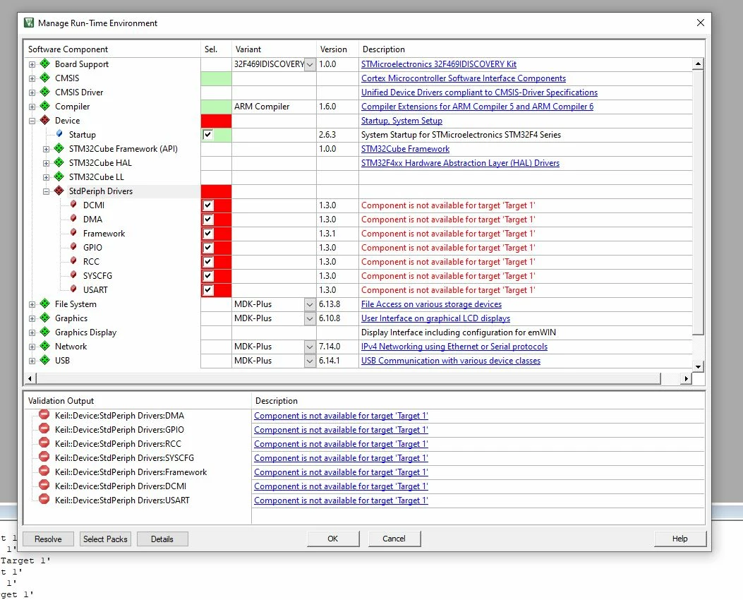

I used this guy's github code, it's about taking pictures with ov7670 and sending to stm32f407VG buffer. But when downloading the code to the computer and testing it, it fails. In the Device section displayed in red like so.
Here is that Github link and the answer of the owner of this code, but i don't understand what he said, i followed his answer but it failed
https://github.com/furknclk/OV7670_STM32F407VGDISC

The missing components are in "StdPeriph drivers". This pack is not installed.
It is not related to DSP. It is not a part of "Cube" library v 1.8,
--pa

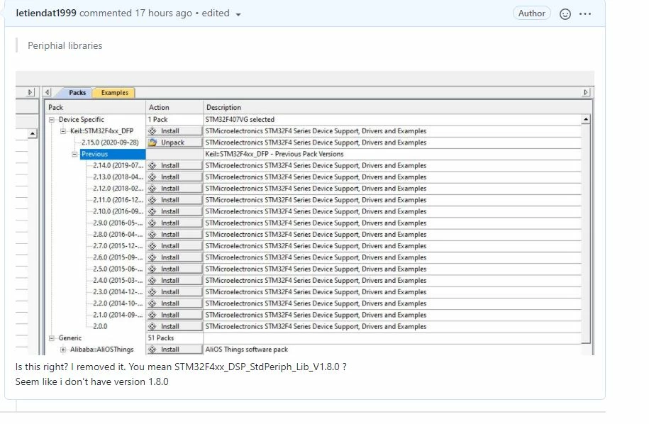

LĐạt.1
LĐạt.1Author
May 16, 2021 11:49 AM UTC
0693W00000AOWjQQAX.jpgYou mean this file?
