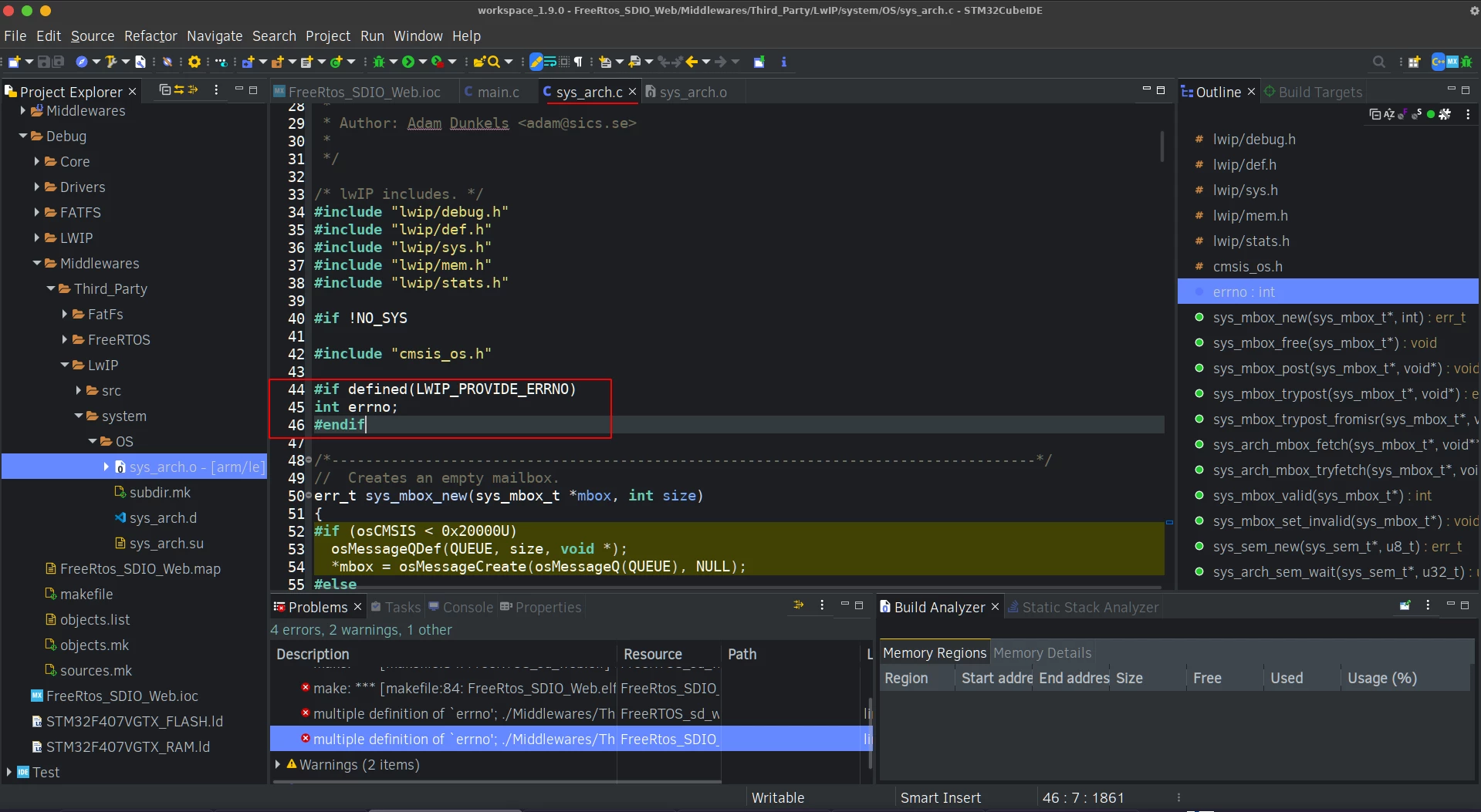

How to fix "multiple definition of `errno"'?
I try to create a new project, nothing is written in main.c! It is a first check after setting up 'LWIP', 'SDIO' and Freertos in the GUI and got this mistake!
multiple definition of `errno'; ./Middlewares/Third_Party/LwIP/system/OS/sys_arch.o:/home/denis/STM32CubeIDE/workspace_1.9.0/FreeRtos_SDIO_Web/Debug/../Middlewares/Third_Party/LwIP/system/OS/sys_arch.c:45: first defined here
Remove all but one? Make some weak?
Make sure multiple instances of the same object aren't pulled in

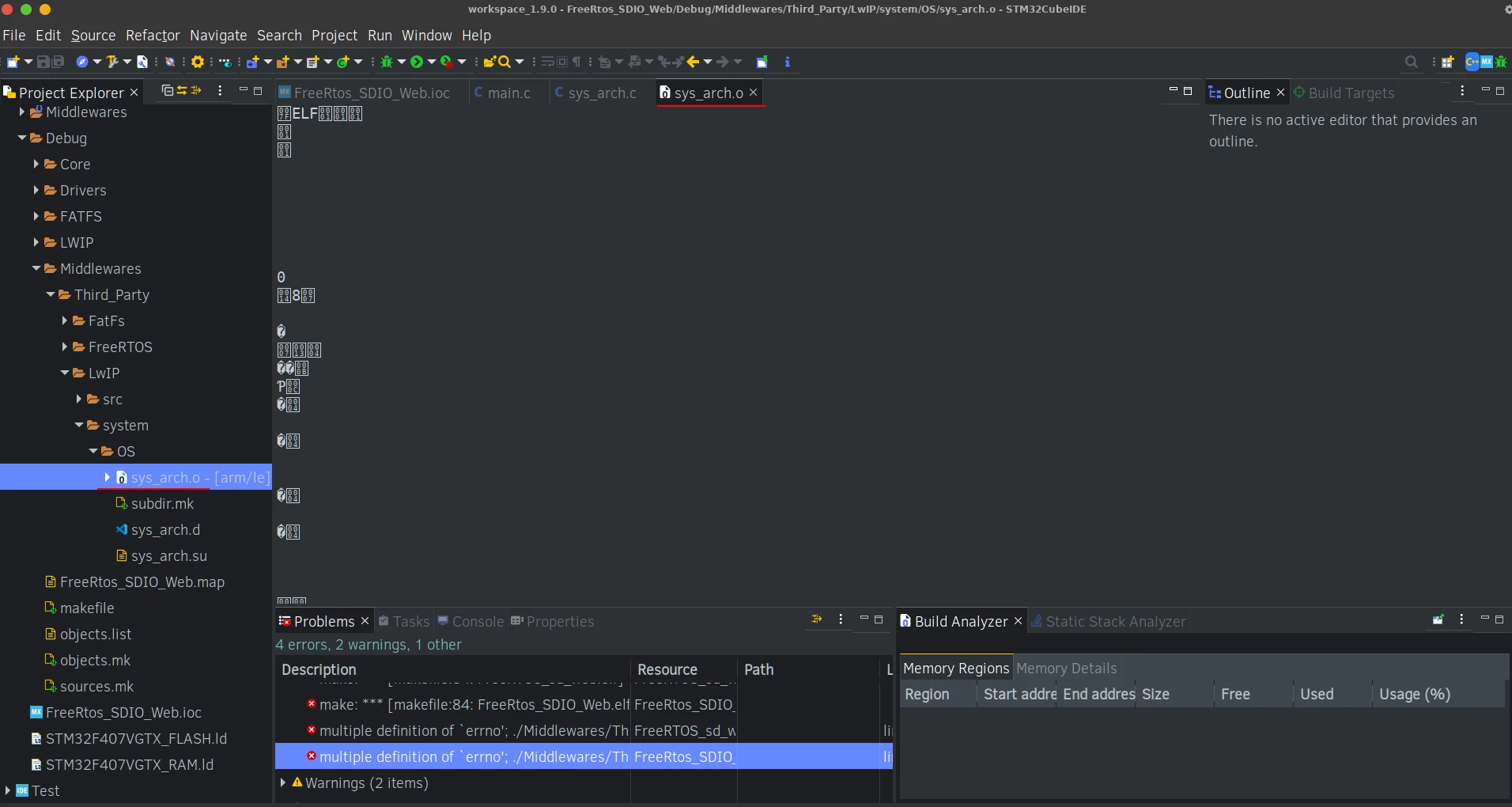

The file "sys_arch.o" is not readable.
And if I will comment three lines in the file sys_arch.c is it will correct?
I'm asking because according to the error /Middlewares/Third_Party/LwIP/system/OS/sys_arch.c:45: first defined here0693W00000Lw2S7QAJ.png0693W00000Lw2RnQAJ.png

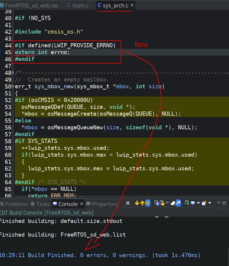

You can just add extern before the int errno.

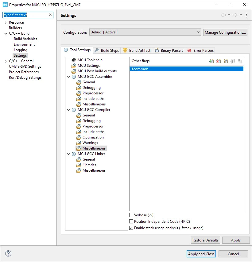

waclawek.jan
Mar 28, 2022 8:38 PM UTC
From the thread I linked to:
> ... use -fcommon to compile ...

"extern" is not good at all. The C library can be thread-enabled and define its errno like this:
struct thread_context_s {
 int m_errno;
extern thread_context_s * thread_ctx_ptr;
#define errno (thread_ctx_ptr->m_errno)

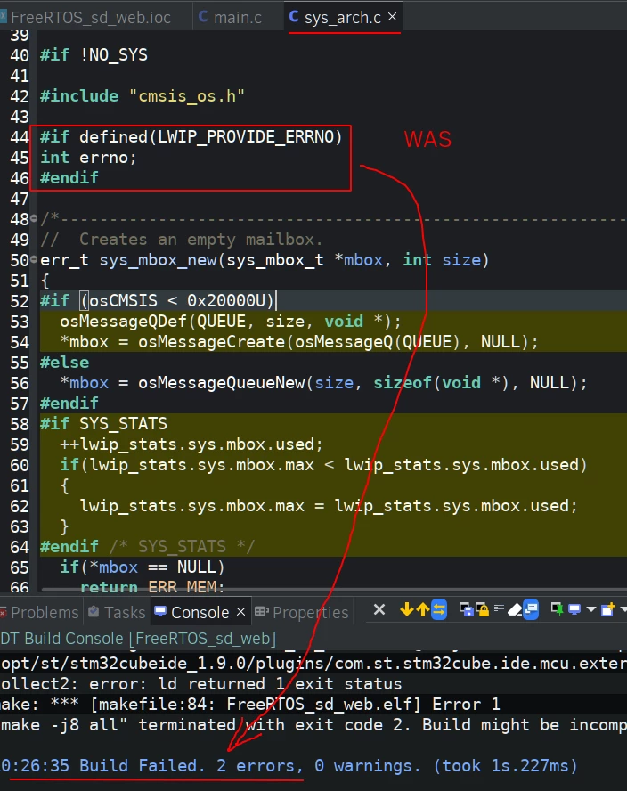

DK.7
DK.7Author
Mar 29, 2022 7:39 AM UTC
Thank you for the explanation but, I am not from those who can change rules in the standard libraries of 'C'.
How do I need to do it right according your mention?
Below on the screenshots, I showed the current state.0693W00000Lw5ApQAJ.png0693W00000Lw5AaQAJ.png
Pavel A.
Mar 29, 2022 3:28 PM UTC
Just follow the "single definition" rule: #include <errno.h> everywhere, remove any other definitions of errno.
LwIP is not a "standard library", it is a add-on component. It is not in position to override errno for the rest of application.

@Community member​ 's solution of building with -fcommon also works for me.
