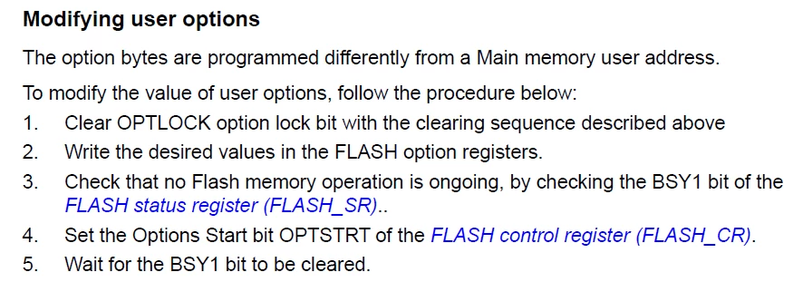

Option bytes can't be modified like RAM memory. You need to unlock the flash prior to it. Per the RM:

Thanks for pointing this out! I definitely just needed to read a few more lines and I would have seen that. I've got this implemented now using the following code:
 HAL_FLASH_Unlock();
 HAL_FLASH_OB_Unlock();
 SET_BIT(FLASH->OPTR, FLASH_OPTR_nBOOT1);
 SET_BIT(FLASH->OPTR, FLASH_OPTR_nBOOT_SEL);
 CLEAR_BIT(FLASH->OPTR, FLASH_OPTR_nBOOT0);
 while (READ_BIT(FLASH->SR, FLASH_SR_BSY1))
 // wait for flash operation to finish
 SET_BIT(FLASH->CR, FLASH_CR_OPTSTRT);
 SET_BIT(FLASH->CR, FLASH_CR_OBL_LAUNCH);
 HAL_NVIC_SystemReset();
 break;
