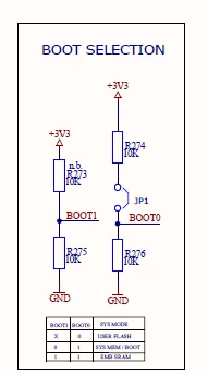

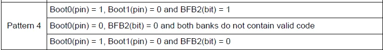

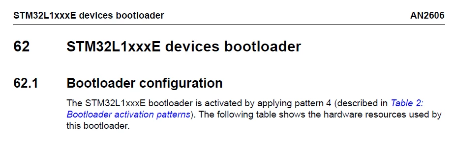

Currently, I am using the STM32L162VE custom board. I want to enter the USB DFU mode but am not able to enter the mode. This chip supports the USB and USART pre-programmed bootloaders. I have referred to the application notes AN2606 and AN3156. I did the below steps with reference to AN2606.0693W00000aIvUhQAK.png0693W00000aIvVBQA0.png
For making the BOOT0 pin to 1, have connected the JP1 jumper and Boot1 making as 0 as below.0693W00000aIvVLQA0.pngIs there any DFU standalone application for STM32L162VE/ ZE?

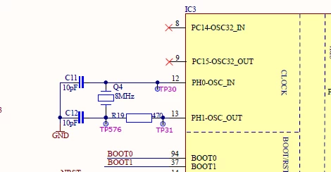

Maybe the problem here might be caused by the HSE crystal.
For that, I advise you to follow this FAQ: DFU mode with system bootloader is not working, while USB does.

I am using 8Mhz external oscillator on the board as below.
0693W00000aIzrkQAC.pngI have a few doubts as below.
