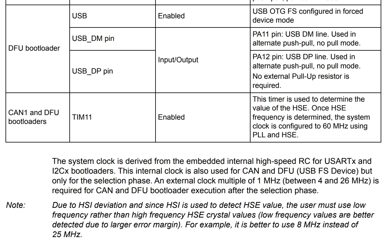

How to enter bootloader without Boot pins on STM32F72?
hi,
We're using the STM32F7 in our project and would like to flash over USB. In the host application we use USB for data transfer which works well. Unfortunately, I have had no success getting the device into the bootloader as we have no access to the boot pins. I tried this code I found on the internet but the the linux dfu-util -l command says no dfu devices found. I noticed this command takes a long time, same with lsusb when the board is in the bootloader (if it even is). Maybe the USB enumeration ist working properly?
We use a 32 MHz HSE but that doesn't get initialized until after the bootloader is called. Any idea on what could be wrong?
Any help would be greatly appreciated!
best regards,
dominik

MM..1
Nov 21, 2022 5:51 PM UTC
Your code is for secend test. Primary use pins and read AN2606

Thanks for your replies.
This is exactly what I am concerned about. Here in in the AN2606 it says HSE must be less than 26 MHz, we use 32. So does that mean I have no possibility of using the USB bootloader?
Also, I'm not sure what to do with the option bytes. Should I change what happens when the boot0 pin is low so that it runs the bootloader? How will it start my code afterwards?Is this really the recommended way of entering the bootloader from software? It seems rather complicated and not to mention risky as the document said corrupt write can cause device to lock.

Tesla DeLorean
Guru
Nov 21, 2022 7:46 PM UTC
You can create your own USB DFU loader that supports the hardware you've built. Can deal with whatever pins, clocks or external memories you've used.
There should be examples in CubeF7
When using the ROM's loader you need to account for every pin it might be monitoring for signals and the limitations/constraints of a one-size-fits-all approach.
DEyer.1
DEyer.1Author
Nov 21, 2022 7:48 PM UTC
So there is no means of configuring the ROM's bootloader via some register settings or the like? It always cascades through that full chain of possible flash sources i2c, spi usart etc?
Thanks for the hint, I'll see if I can find that example.
