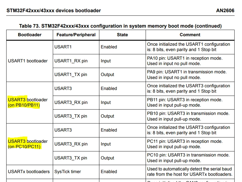

  • looking at the document AN2606 p 172, you can see that bootloader USART3 is only accessible through the pins PB10/11 or PC10/11

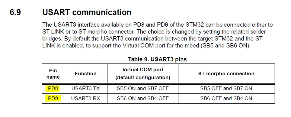

  • Meanwhile in the document UM1974 of the nucleo board, you can see page 26 that the virtual com port of the embedded ST-Link is connected to USART3 through the pins PD8/9

You cant use ST Link COM Port
Read AN2606 p172
