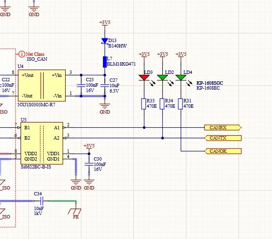

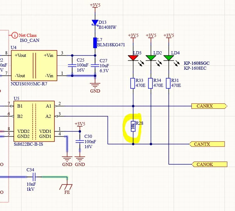

GHese.1
GHese.1Author
Jul 11, 2022 10:08 AM UTC
0693W00000QKqgwQAD.jpgWhether the USB cable detection triggers depends on the isolator used.
With an Is8622BC it works fine, with ADUM1281ARZ it doesn't work.
It sounds ridiculous but with a resistor between the CAN1Rx (USB-DM) and CAN1Tx (USB-DP) it works fine with both, Is8622BC and ADUM1281ARZ.
I have reworked 10 PCBs, all working fine.
waclawek.jan
Jul 11, 2022 10:16 AM UTC
Again, why do you think your problem is namely "USB cable detection"?
GHese.1
GHese.1Author
Jul 11, 2022 11:32 AM UTC
None of the PCB's communicate through Usart3 in boot mode. I send 0x7F, there is no response.
Until you desolder U5, R33 and R34 (connected to CAN/USB port)
