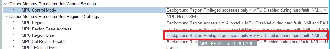

Second, Table 2 shows the default MPU memory region attributes for Cortex-M. So, this does not mean the cache is enabled by default but the region is cacheable. For example for the regions defined by default as device or strongly ordered and even you enable the cache using SCB_EnableXCache(), that region will not be cacheable.
Third, the difference between what I provided as MPU config is the MPU control mode: MPU privileged default:
 /* Enable the MPU */
 HAL_MPU_Enable(MPU_PRIVILEGED_DEFAULT);
Your code: MPU HFNMI privileged none:
/* Enables the MPU */
LL_MPU_Enable(LL_MPU_CTRL_HFNMI_PRIVDEF_NONE);
So set it to MPU privileged default.
In CubeMx:
You need also to look at the Cortex-M7 programming manual PM0253 STM32F7 Series and STM32H7 Series Cortex®-M7 processor

Pavel A.
Sep 3, 2024 8:55 PM UTC
Try LL_MPU_CTRL_HFNMI_PRIVDEF instead of LL_MPU_CTRL_HFNMI_PRIVDEF_NONE.
SKS2CNCAuthor
Sep 5, 2024 7:18 AM UTC
Sorry for the long answer - I was testing!
Thanks to everyone - advice with LL_MPU_CTRL_HFNMI_PRIVDEF - the cache is disabled for the necessary memory areas - this is what you need!

I don't use the cube much - it was enough for me to solve
LL_MPU_Enable(LL_MPU_CTRL_HFNMI_PRIVDEF);
By the way, for some reason I didn’t find these LowLevel functions in the UM2217 ;)
