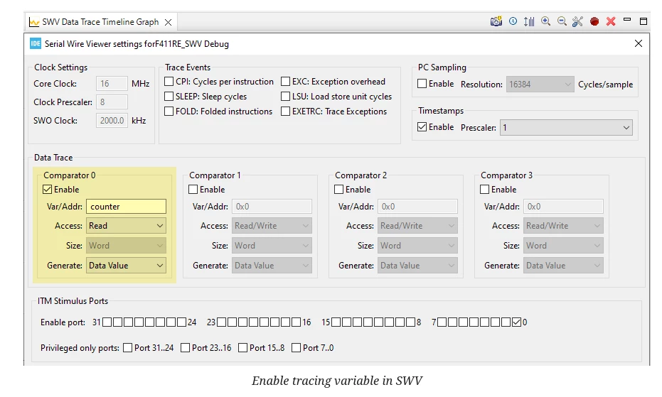

AScha.3
Apr 14, 2024 7:57 AM UTC
If you have SWO connected, you could try with SWD to catch the writing to the variable address of interest :
https://www.codeinsideout.com/blog/stm32/swv/#inspect-variables
