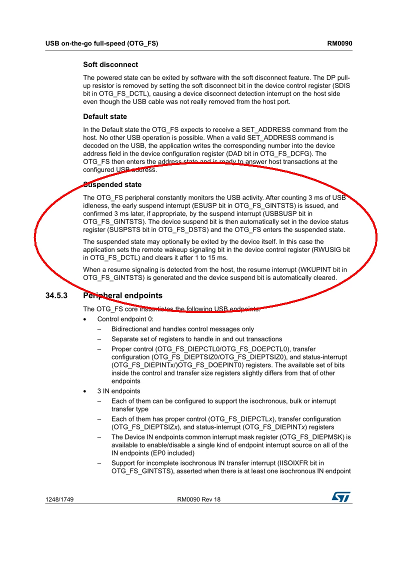

waclawek.jan
January 8, 2021
0693W000006I44MQAS.pngJW
FKopp.1
FKopp.1Author
January 8, 2021
This seems to be talking about OTG devices, but I'm just a regular FS usb device

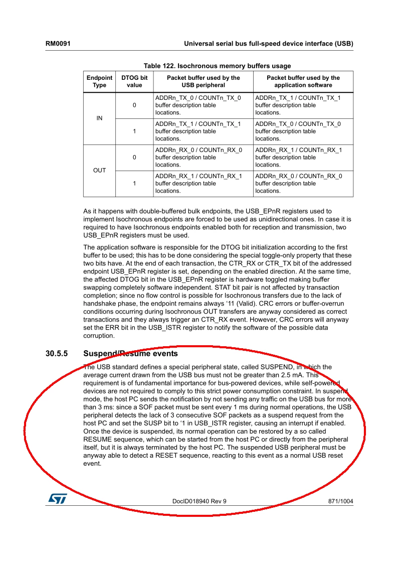

waclawek.jan
January 9, 2021
You did not care to tell us which STM32 are you using, and my crystal cube told me the wrong one. So one more guess:
FKopp.1
FKopp.1Author
January 9, 2021
Thanks for the reply, The device is an stm32L151C8T6A
I'm doing the following check continuously in the main loop
if(USB_ISTR & USB_ISTR_SUSP){
The bit seems always to be 1. Is there something else I need to enable to make this work?
