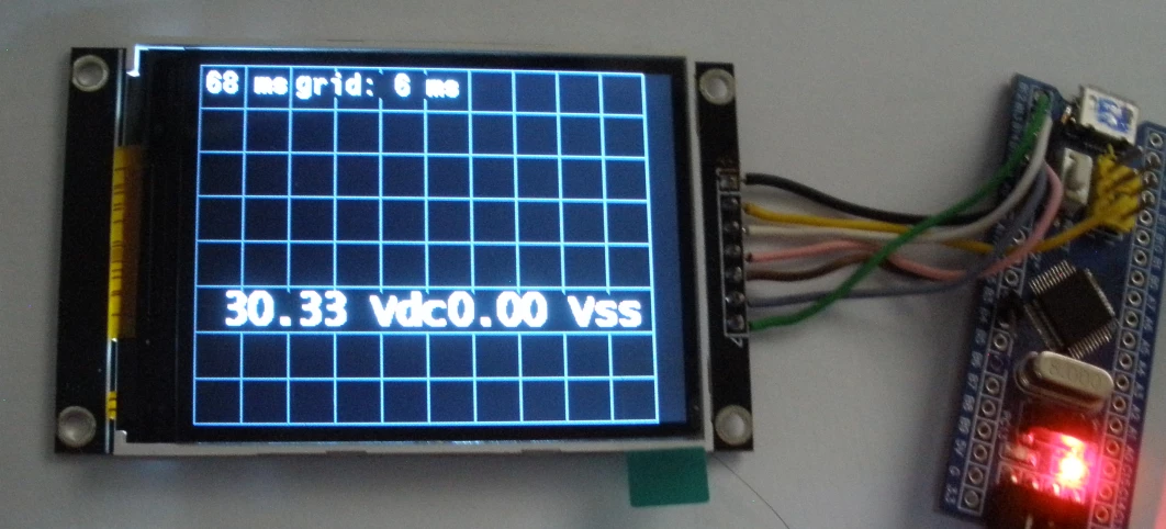

example: I want to use a small TFT , 320x240 pix, on a STMF303 :
- set up cpu , clock tree, SPI with Cube
- search ILI9341 lib on github....ok, adapt it to my F303, just using the HAL ( HAL_SPI_Transmit(&ILI9341_SPI_PORT, buff...) )
- compile, check, ok, write a grid (like on a DSO) to the TFT
- grid writing needs about 305ms , slow..., so writing the color data now by writing to SPI register direct: 6 ms ! ok.
Now its ok for me, good speed and minimum time spent to do it.
