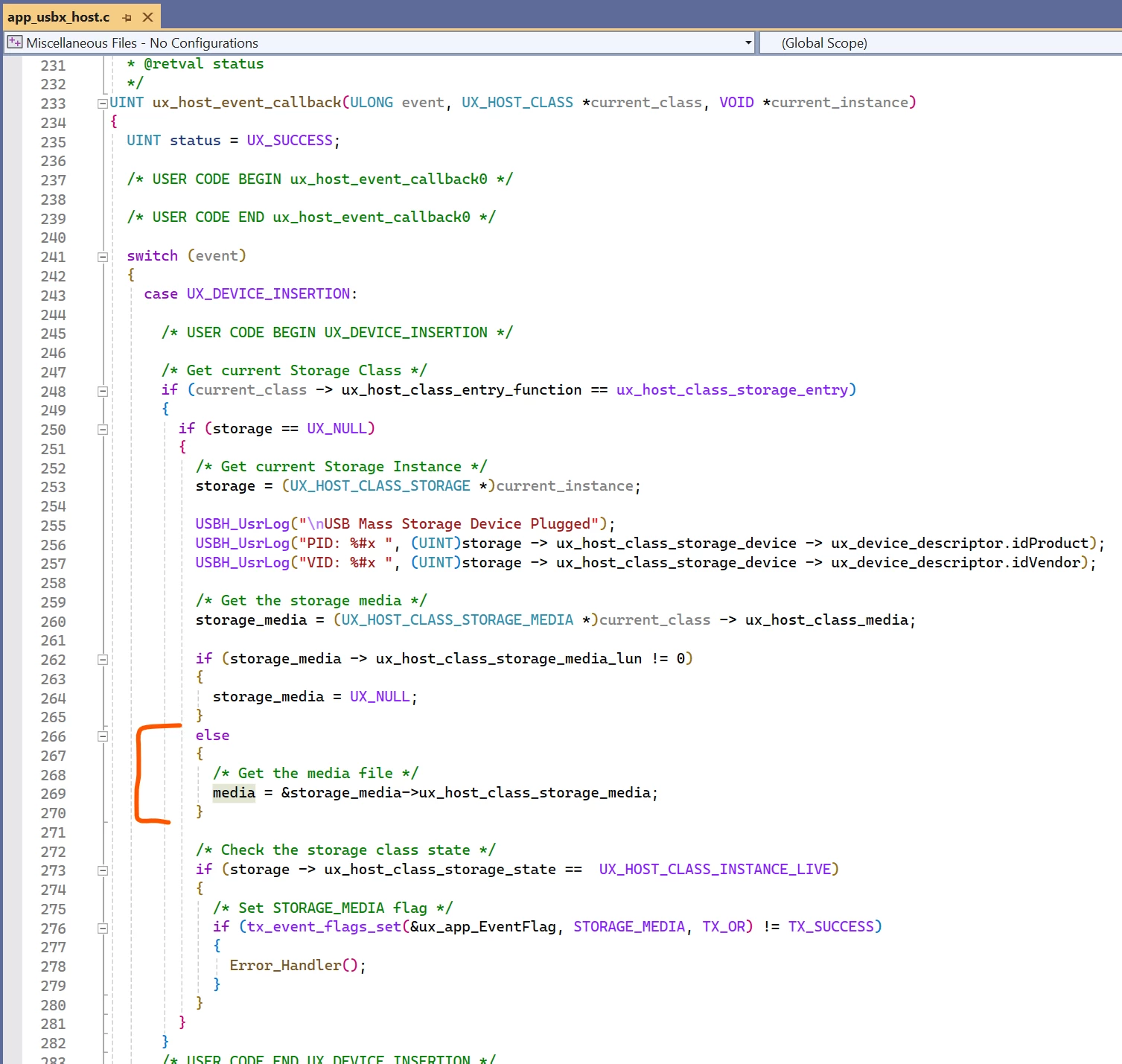

When I tried to implement something meaningful in UX_DEVICE_INSERTION status, it turns out that the expression
 media = &storage_media->ux_host_class_storage_media;
fails to compile because the type "FX_MEDIA" is undefined. I need FX_MEDIA so I can use functions like fx_file_open or fx_file_read.

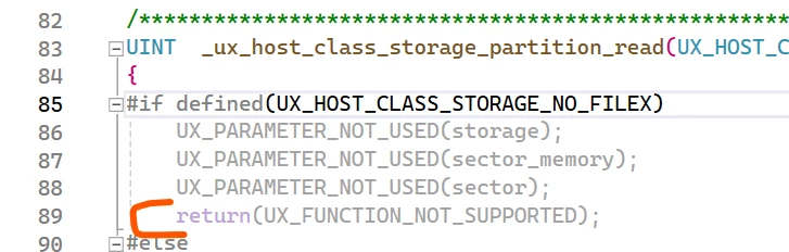

Apart from the undefined type, the field itself is if-def'ed away within ux_host_class_storage.h:

and the #defines are set earlier:
#if defined(UX_HOST_STANDALONE) && !defined(UX_HOST_CLASS_STORAGE_NO_FILEX)
#define UX_HOST_CLASS_STORAGE_NO_FILEX
#endif
I thought maybe I could tweak this vendor file (slightly queasy about that). But that's when I found statements like this littered throughout the library:
I want FileX (and picked it in Cube), so this #define is confusing. I guess the question is: what is the proper configuration of #defines to bring all these pieces together properly? Or is standalone host msc not a supported feature? Are there lib tweaks I can make that will fake it?
