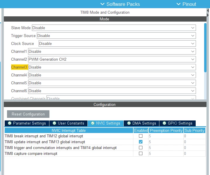

I have a project that is not mine that have a pair of files called stm32h7xx_hal_timebase_tim.c and stm32h7xx_hal_tim.h. In the .c TIM8 appears but when i configure it in the MX for example like this:
Anyone knows how to make these files using MX?

You want choose a timer as sys timebase ?
here choose it :
-- thats all.

So easy, thank you so much for your help! @AScha.3
