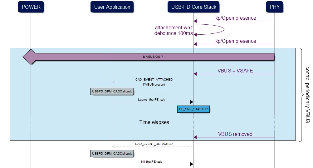

I purchased a NUCLEO-G431KB to begin and test firmware development of my project, using the latest STM32CubeIDE with the STM32Cube_FW_G4_V1.1.0 library BSP.
Following several USBPD library examples of a sink application -- and some considerable configuration to FreeRTOS and the initial STM32Cube-generated code -- I am able to build the firmware, flash the target, and debug via ST-Link running on the little NUCLEO device.
I can verify the USBPD middleware thread and the TRACER_EMB utility thread are being created by FreeRTOS. But the main USBPD process that listens for USB Type-C cable attach/detach seems to hang and never return (and it never calls any of the installed callback functions). This function is part of the CAD module I believe and is named USBPD_CAD_Process().
Unfortunately this function is implemented in the library core USBPDCORE_PD3_FULL_CM4_wc32.a (binary distribution), so I don't have any visibility into why it is hanging or not calling my callback functions. And I can't find any good documentation on troubleshooting this area of USBPD library either.
Also a side note -- I'm not real certain how to actually use the TRACER_EMB utility, and the STM32CubeMon-UCPD application does not detect any boards present when I have the target running.

Dear Andrew,
I have a question linked to your VBUS connnection. How to do you measure it?
In our reference design, I added a voltage divider on VSENSE and map it on ADC channel on our MCU.
For instance, on our NUCLEO-G474RE, we use a TCPP01-M12 extenstion board and read the VBUS thanks to the VSENSE pin connected to our ADC:
Please find a message sequence chart for SINK connection:
"Is VBUS On?" is done through functions:
=> ManageStateAttachedWait_SNK -> CAD_Check_VBus -> HW_IF_PWR_GetVoltage -> BSP_PWR_VBUSGetVoltage
And then in 'usbpd_pwr_user.c', when CAD detects a connection, it should wait for getting VBUS at 5V before starting PD stack thanks to the following function:

11 replies

Dear Andrew,

Thank you very much for such great detail! I was attempting to measure VBUS by setting the following option in the device configuration tool in STM32CubeIDE:
Under Pinout & Configuration > System Core > SYS; for option Power Voltage Detector In, I selected External Input Analog Voltage, but I wasn't wiring anything from the Type-C port to that pin on the MCU, as I didn't realize it was necessary for basic cable detection (I assumed it only needed the CC pins).
But looking at your message sequence chart for SNK, I now see why it is necessary! I also see that I'm using the wrong mechanism for VBUS measurement. According to the video linked by @Nicolas P​ in the other answer, it suggests the USBPD stack actually depends on defining the user label of an ADC pin to "VSENSE". So this is how a given ADC input is associated with the USBPD stack?
I am positive I do not correctly implement the VBUS measurement in BSP_PWR_VBUSGetVoltage. I will implement the required ADC configuration and VBUS measurement routines, and I will copy your same voltage divider and attach VBUS to the ADC input. I can use my multimeter to finesse the multipliers appropriately.
