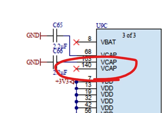

Hi
I'm having troubles programming the stm32h755zit6 on my selfmade PCB. The schematics should be right, as i am able to programm the STM32. But if i run a simple code inwhich a certain pin should be pulled up high, it just won't work. Therefore I thought about debugging the code to see whether it reaches the part inwhich the GPIO-function is called. But instead it doesnt and ends up in a error_handler. Afterwards i somehow am not able to reprogramm the STM32H755 anymore as the message following message appears:
stmicroelectronics st-link gdb server. version 7.10.0 copyright (c) 2025, stmicroelectronics. all rights reserved. starting server with the following options: persistent mode : disabled logging level : 1 listen port number : 61234 status refresh delay : 15s verbose mode : disabled swd debug : enabled initwhile : enabled target no device found error in initializing st-link device. reason: no device found on target.
I have no done this over and over again three time an i always had to desolder the old uC and solder a new STM32 on my PCB, only for it to get the same result. Now I ran out of STM32s and thats why i need your help.
Its probably not possible to solve this problem without any code or schematics, so please tell me what you need. :D
Thanks in advance!!!

Best answer by _oepfel
Thanks a lot this now fully solved my problem(s) and the pin is set to high. So now I can start with programming the real code.
To Summarize what I did for others:
1. VCAP and VSS were connected falsely --> solved "Target no device found"
2. under Pinout & Configurations > System Core > RCC > Parameter Settings > Supply Source > PWR_LDO_SUPPLY --> solved "Target is not responding, retrying..."
3. deleting the following code:
/* USER CODE BEGIN Boot_Mode_Sequence_1 */
 /* Wait until CPU2 boots and enters in stop mode or timeout*/
 timeout = 0xFFFF;
 while((__HAL_RCC_GET_FLAG(RCC_FLAG_D2CKRDY) != RESET) && (timeout-- > 0));
 if ( timeout < 0 )
 Error_Handler();
/* USER CODE END Boot_Mode_Sequence_1 */
--> solved being stuck in Error_Handler();
Many thanks to @TDK and @MM..1 you are some true heroes and I appreciate your help!

_oepfelAuthor
June 8, 2025
Schematic would help. Code would help.
I have attached the schematics.
The code is basically a bare STM32H755ZIT6 project inwhich I have tried to set pin PF11 to high. In RCC I have once tried without HSE and once with HSE Crystal/Ceramic Resistors
I am able to program the whole code but I am unsure how to handle the programming with two cores.
And as mentioned, each time I tried to debug the code and determine where it gets stuck, I somehow end up getting the following error message and I am not able to programm the STM32 anymore.

VCAP capacitors are critical to general functionality.
I'd recommend using the Error_Handler() method passing __FILE__, __LINE__, it will save you a lot of time,and works in the field and for those without a debugger attached.

June 8, 2025
VCAP3 should be connected to the other VCAP pins.
VSS/VSSA pins should be connected directly to ground.
Getting started with STM32H74xI/G and STM32H75xI/G MCU hardware development - Application note
_oepfelAuthor
June 8, 2025
Thanks a lot, could this solve the other problem I had with not being able to programm the stm32 anymore after debugging, or might this be something else you noticed?
Because I only have on brand new STM32H755ZIT6 left and I don't want it to get the same results.
June 8, 2025
I don't know if this is the problem, but they are certainly two of the problems that need to be solved before you have a properly functioning chip. VCAP is important. Solid ground connection is important.
_oepfelAuthor
June 8, 2025
I have now corrected the stm32 vcap and vss pins but I am getting the same result after pressing "run".

 and the message i receive is:
Memory Programming ...
 File : ST-LINK_GDB_server_a28400.srec
 Address : 0x08000000
Erasing memory corresponding to sector 0:
Erasing internal memory sector 0
Download in Progress:
File download complete
Time elapsed during download operation: 00:00:00.972
Verifying ...
Download verified successfully
Shutting down...
is there any way to share the whole project or don't you need that?
What could I do next
