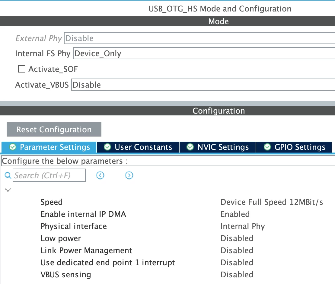

I have enabled USB with the following settings:

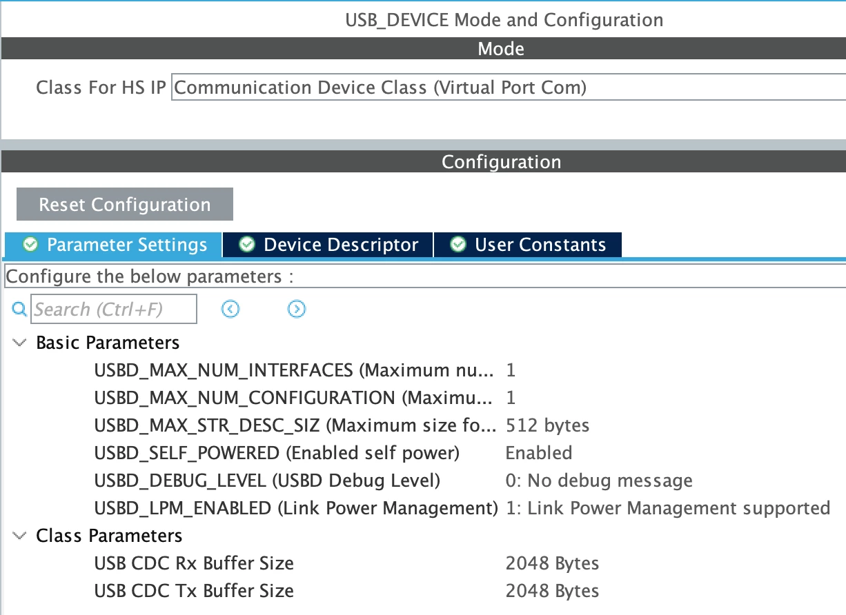

Following USB middleware is enabled like so:

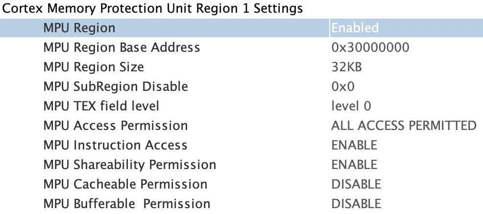

I also tried to enable MPU like so:
But that did not do the trick.
However, when RAM region base address (0x24000000) is used instead of RAM_D2 (0x30000000) for MPU, device enumerates correctly:
and there is no need for:
__attribute__((section(".dma_buffer")))
on rx and tx buffers anymore.
Now the question. How to correctly place only the USB related stuff to non-cacheable region so that rest of the application can work with cache enabled?
In summary, Currently I have disabled cache with MPU for entire region (RAM (xrw) : ORIGIN = 0x24000000, LENGTH = 128K). USB with DMA works, but it means that rest of the application also is experiencing disabled cache which is not what I want. I only want to disable cache for USB stuff. It is not enough just to place rx and tx buffers in non-cacheable region. From findings, it seems that also descriptors and potentially other stuff must ble placed in non-cacheable region as well.

It is not enough to move only UserRxBufferHS UserTxBufferHS to a non cacheable section.
The complete USB data path must be reviewed to identify all DMA buffers and descriptors.
Using MPU to mark the entire SRAM region as non cacheable will work, but as you noted, it is not an ideal solution because it impacts the rest of the application.
Typically, the recommended approach is:
  1. Keep the application in cacheable memory
  2. Reserve a dedicated non cacheable region for USB DMA buffers and descriptors
  3. Place all USB DMA accessed buffers and descriptors in that region
  4. Ensure cache maintenance is applied where needed for any cacheable data exchanged with USB.

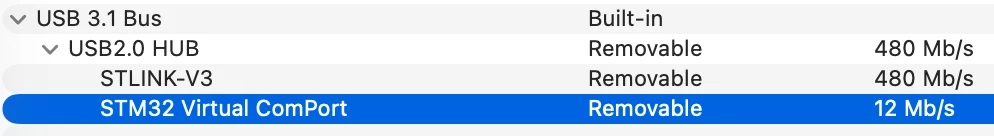

>  At this point USB device enumerates but looks like no descriptors are transferred to the host.
Ok, but you show just the st-linkV3 enumeration, on st-link usb connection.
But the user usb is the other usb , CN13 .
So connect there a usb cable to PC also, then you see...enumerates or not.
btw
What kind of device it should be ? set it in Cube ? VCP ->
Apr 6, 2026 12:13 UTC
Not correct. ST-Link and VCP are connected to the same USB hub. It can be seen on the original posts. Device with blue background is the VCP device.
Very new to the HW
