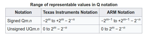

Q1.15 (from Wikipedia)
is in "arm world" -0,999 ... +0,999 , 1 sign + 15 bits fractional.
Simplest conversion for example 100 : in Q1.15 -> 100 ( 0x0064 as int16 ).
And back conversion : 0x0064 -> 100 . great , simple. :)

Its just about doing complex math in integer, not float, but not get internal overflow in the calculation.
So the integer is treated as always smaller than 1 , giving in multiplication ( 1 * 1 -> ) 1 maximum, no overflow can happen. Thats it.
Any normalization only makes sense, if your data lets say, is in range 5...100. (100 is maximum.)
So you want best precision, then adjust by:  data * (32767/100) , and back after math : result *(100/32767) , so keeping best dynamic range .
