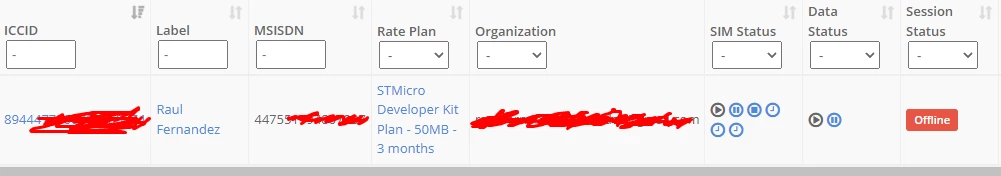

How to connect the B-L462E-CELL1 to TRUPHONE?
Hi there,
Yesterday I unboxed my B-L462E-CELL1 and tried to get it connected to TRUPHONE. I managed to register the board with TRUPHONE esialy following the instructions.
Then I powered the eval board but it did not connected. Using the flashed firmware,   X-CUBE-CELLULAR Version: V5.2.0, ATCModem:NetworkState (EPS) = NOT_REGISTERED_SEARCHING.
Finally, I upgraded the firmware using the binary file in the en.patch_x-cube-cellular_v6-0-1, with the same results : ATCModem:NetworkState (EPS) = REGISTRATION_DENIED and ATCModem:NetworkState (CS) = NOT_REGISTERED_NOT_SEARCHING.
Any help would be appreciate it?
I am in the Glasgow (UK) so the TRUPHONE coverage should be fine.

S.RA
Oct 5, 2021 1:07 PM UTC
Hello Raul,
Thanks for purchasing the discovery board for cellular.
You have done the right things to get attached to the network. Would you able to enter a command from the terminal (teraterm) connected to the board via ST LINK? If yes, then please enter the command at at%nwoper? .
Then it should return DEFAULT
Now enter the command at at%nwoper="TRUPHONE". It will configure the Modem to use TRUPHONE specific features to manage the multi-IMSI function.
Then, please share the complete log (trace) you can get on the terminal and share with us for further analysis.
Thanks a lot
Best Regards
Solofo
