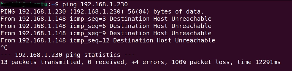

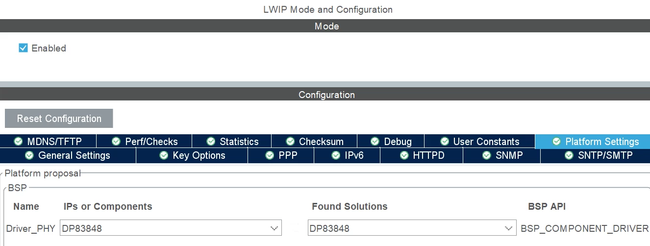

I have an XCore407I board with an Ethernet port installed. I'm trying to create a simple UDP server in Stm32CubeIDE. Compilation and uploading to the board is OK. But the board doesn't respond to ping and isn't visible in the router's device list.

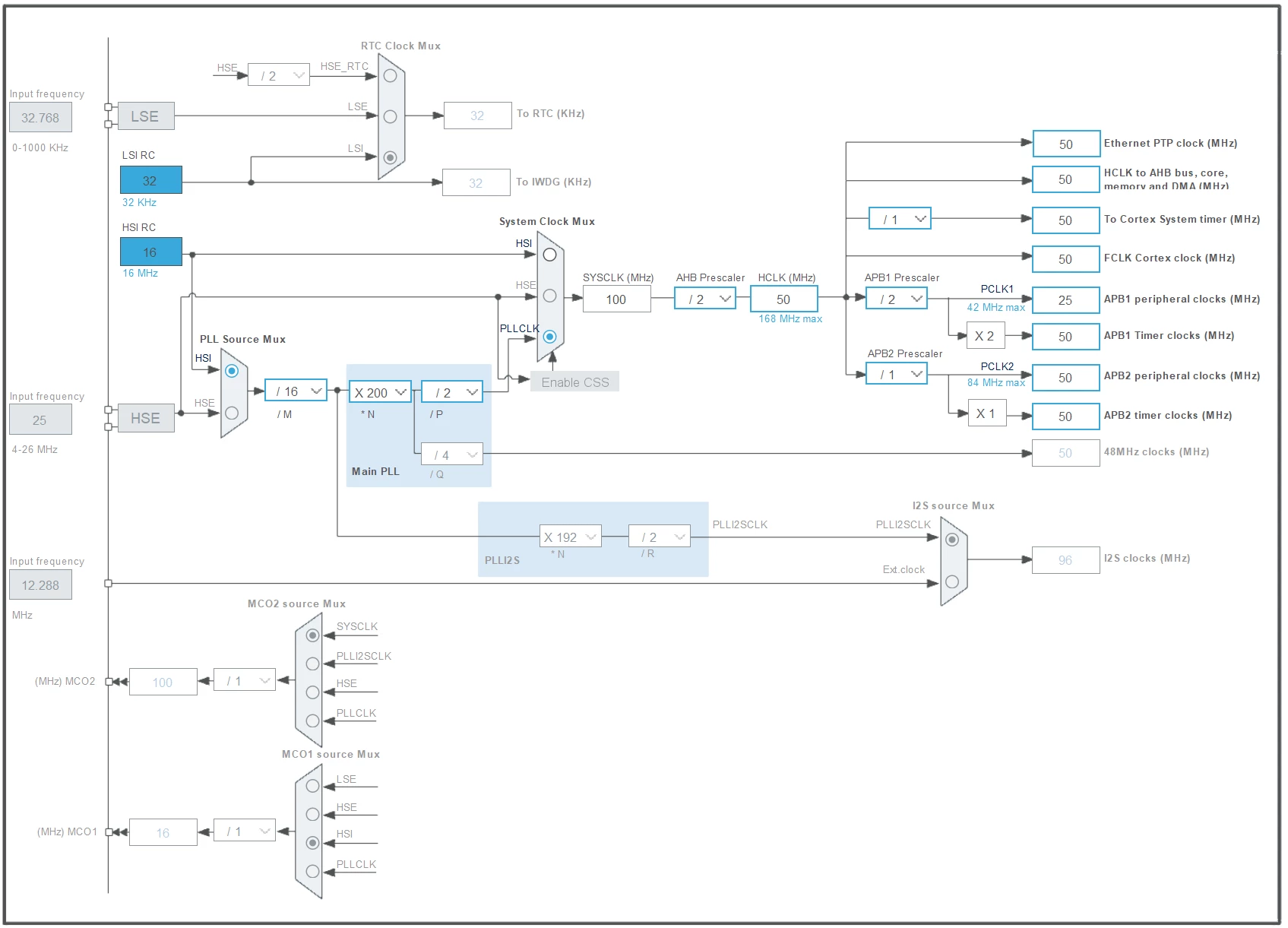

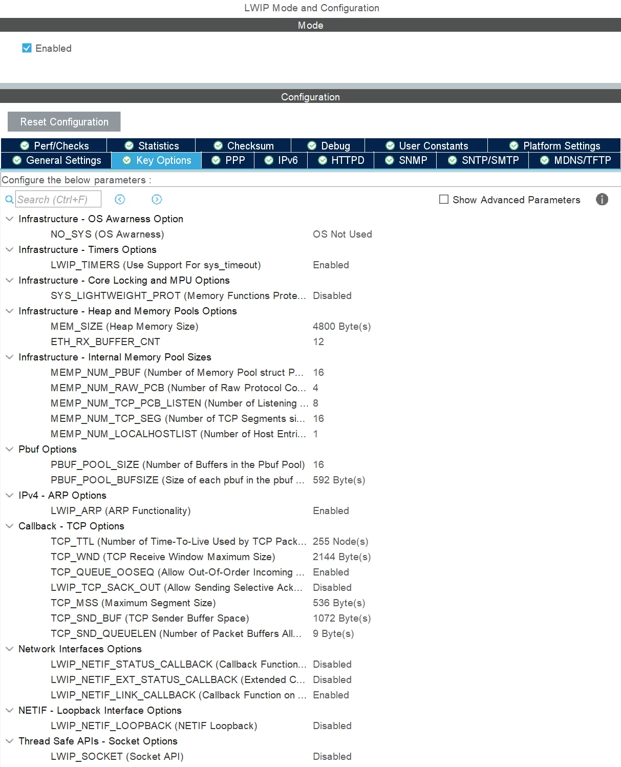

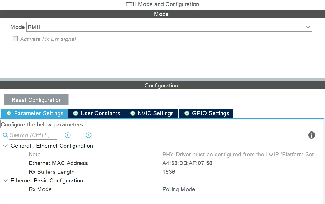

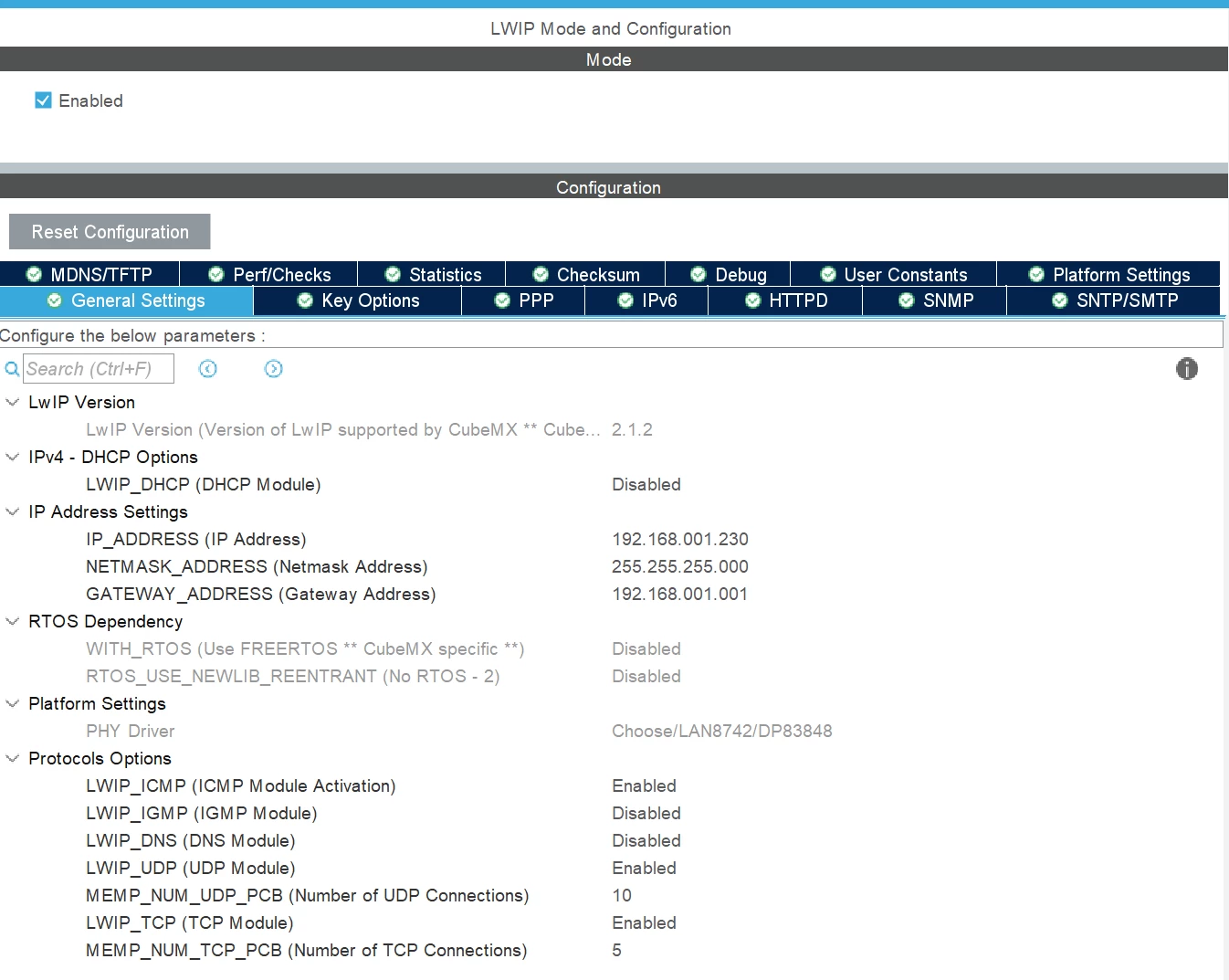

Here are my settings in IDE.

Thanks for the reply. Yes, it's not an STM board, but it does have an STM32F407IGT6 processor. Are there any nuances to configuring this processor for Ethernet that I've missed?
I've attached the project.

The web page for that board contains some downloads related to ethernet, for one - "stm32f4 IAP ETH".
It is a source project for a ST STM32F4 board with DP83848 PHY. Does the board actually have the DP83848?
Try to use these sources, as the board vendor recommends them.

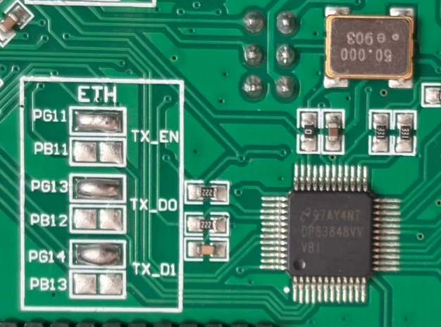

KeshaVAuthor
Feb 11, 2026 9:27 AM UTC
Board have DP83848. See photo:
Sources on vendor's site is outdated and not for Stm32CubeIde. I can't compile them.
