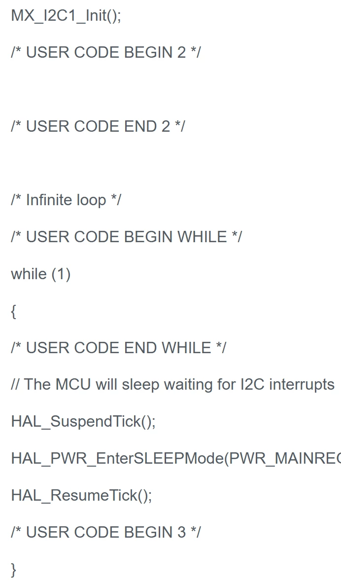

how to configure STM32f030f4p6 I2C as a slave to send data to Master after request
hello everyone i have a small pcb made by myself with an STM32f030f4p6 which will read the data from my ADC and send it to a master (Arduino) via I2C... For a start I just wanted to write a code to test the correct configuration of I2c between the two MCUs by sending a simple constant value from the STM32f030f4p6 after requesting the master ... but it does not work, I also used the examples seen online but even so they do not work. I then decided to scan with the arduino master to see if it recognises the slave connected to the line, then I find that when I compile the scanner code in the master, it identifies the address of the slave just once, but then it doesn't do it any more, returning nop device found as I defined in the scanner code on the ... does anyone have an idea why this is?
these are my first steps with the stm32 microcontroller thank you for your understanding
here is my code of the main.c

while (1)
/* USER CODE END WHILE */
// The MCU will sleep waiting for I2C interrupts
HAL_SuspendTick();
HAL_PWR_EnterSLEEPMode(PWR_MAINREGULATOR_ON, PWR_SLEEPENTRY_WFI);
HAL_ResumeTick();

21 replies
Aug 1, 2024 4:24 PM UTC
Probably a software bug causing it to crash somewhere.
Can you show your code? Have you followed CubeMX examples such as this one?
STM32CubeF0/Projects/STM32F072B-Discovery/Examples/I2C/I2C_TwoBoards_ComIT at e1f18c0ccc4fd53f796351857a97352f43f96e21 · STMicroelectronics/STM32CubeF0 (github.com)
Aug 1, 2024 5:46 PM UTC
hey TDK
the code is above, in the STM32cubeMX I have made all the necessary settings (system core, connectivity)
Aug 1, 2024 7:12 PM UTC
You have to call HAL_I2C_EnableListen_IT to start the listening process. Probably should not enable low-power modes until you get the main program working. Work in steps.
Aug 2, 2024 11:50 AM UTC
Do you have external pullups on SDA/SCL? Do other programs work on your board, such as a program to blink an LED?
Aug 2, 2024 1:53 PM UTC
Sorry, I accidentally clicked accept solutions. Yes, I have a pull-up resistor on the SDA and SCL lines. No, I don't have an LED on my Pcb.
