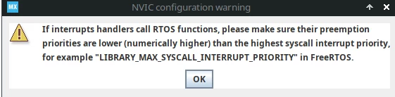

From my understanding in FreeRTOS, there is a defined highest priority one should set for interrupts whose ISRs may call RTOS APIs (configMAX_SYSCALL_INTERRUPT_PRIORITY).
For the same reasons, I would expect ThreadX to have a similar limitation, and to that extent I have found other ST forums posts suggesting one should set lower priorities for any interrupts whose ISRs may call RTOS APIs, but I can't find any documentation that explicitly states what the highest safe/allowable priority is, similar to FreeRTOS.
How do I know what's the highest interrupt priority I can safely set in such cases? Is there any documentation from ThreadX that I'm missing, because I can't seem to find any mention of this.
For context, I am using a U5 series MCU and I want to call queue related APIs in my CAN Rx callback.

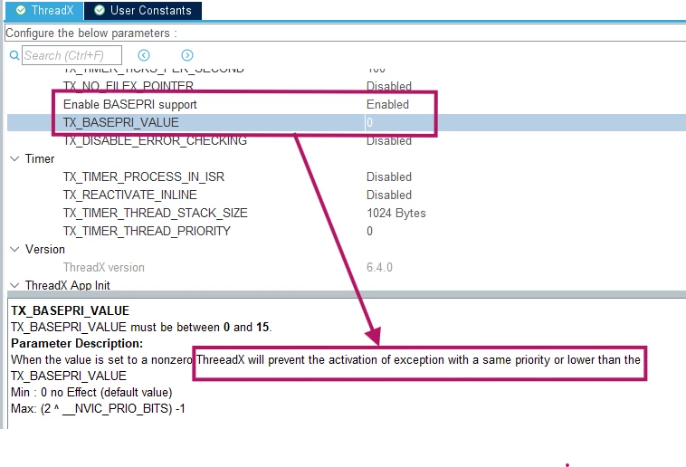

Actually the BASEPRI support is available in ThreadX and configurable in STM32CubeMX.

If you want the rtos working, leave it it's high priorities.
Your tasks then at lower priorities as you like.

in ThreadX you can customize macros TX_DISABLE and TX_RESTORE to behave like in FreeRTOS (use BASEPRI), but it seems that CubeMX GUI does not have this option.

Yeah it's pretty straightforward in practice, but I just want to know (for educational purposes) what the actual hard limit is. I would assume its whatever the lowest priority is between pendSV, SysTick and SVCall?
@Pavel A. Interesting, but yeah, I was just assuming that ThreadX themselves would have a hard limit, or mention somewhere what that recommended limit is

Okay so essentially there is no fixed absolute limit and it is up to developer's discretion what the BASEPRI value is?
I don't fully understand the intended benefit of it in that case, but this answers my initial question regardless.
