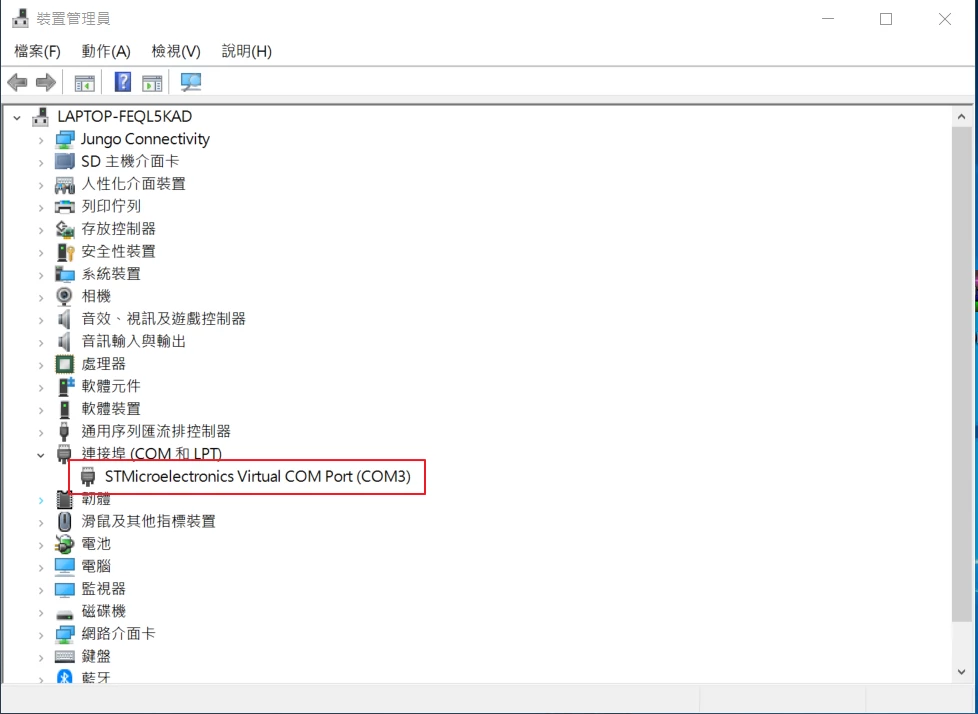

How to change USB COM Port of name ?
Excuse me.
Can I change COM Port of name in keil C ?
if there is no way , how to change it name ?

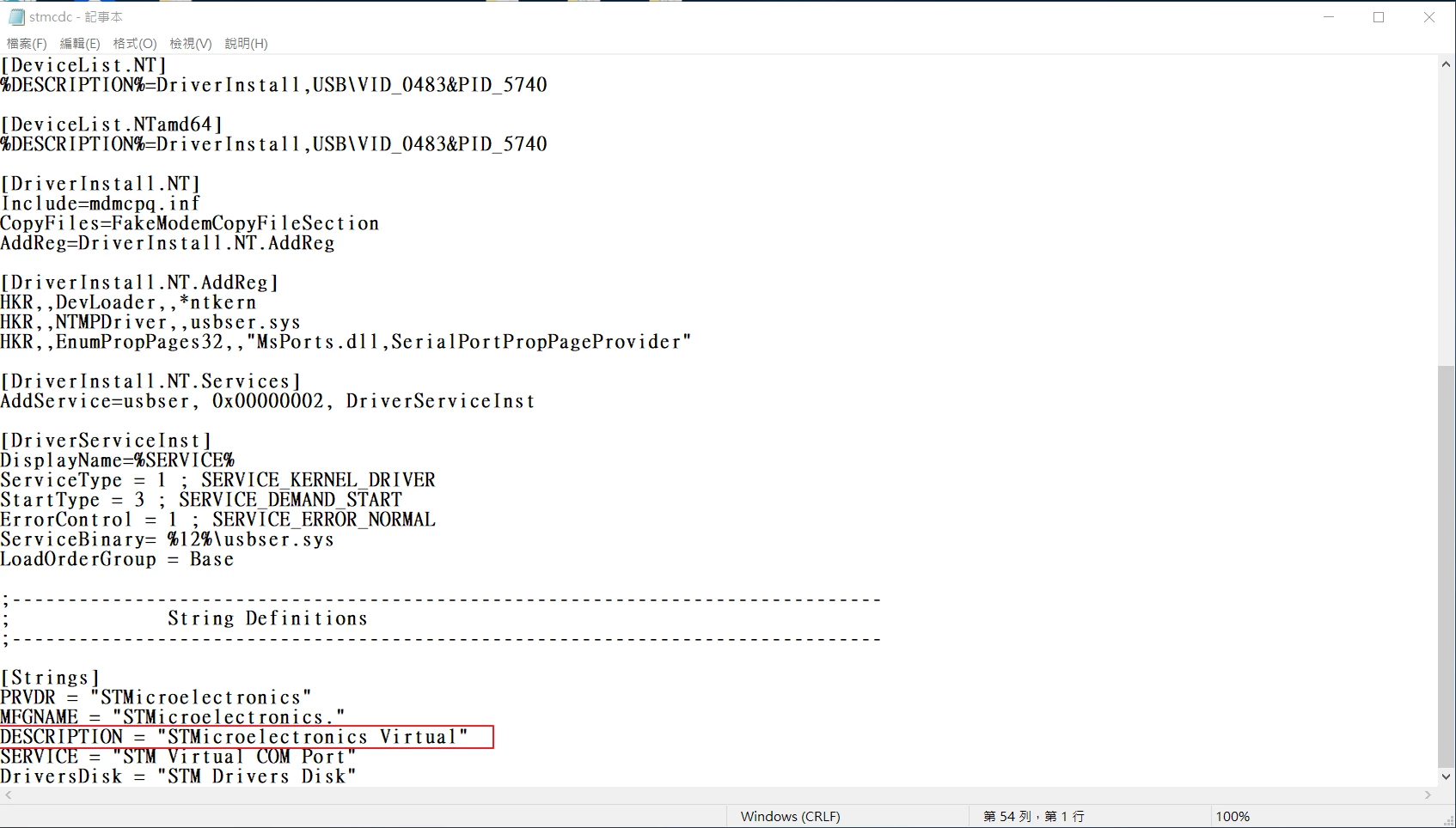

Guru
Aug 1, 2019 5:17 PM UTC
Some of the naming might be found in the descriptors. Windows may associate a name in .INF via VID\PID
Have your own vendor ID, and supply .INF you can likely call it whatever you want.
Might also be able to change present name with the registry entry for the device node.

1123Author
Aug 2, 2019 3:32 AM UTC
Path: C:\Program Files (x86)\STMicroelectronics\Software\Virtual comport driver\Win7
I found .INF file and change DESCRIPTION define .
But I renewed to install , result it failure
It seem have Anti-write mechanism.
Bob S
Aug 2, 2019 6:30 PM UTC
You most likely can't. I don't have it installed on my PC here, but the driver is probably "signed", which means there is a ".cat" file along with the ".inf" file. The ".cat" file contains hashes of all the installation files associated with that driver, including the .inf file. If you edit he .inf the hash changes and Windows won't install it.
I haven't tried this, but I suspect your best bet is to edit the registry after you install the driver (or on Win10, WIndows installs its "in-box" driver). If this is for your own personal use, that should be OK. But if this is for a product that you want to ship, it means you need a way to edit the registry on your customer's PCs. This may be possible from the installer that you would have to create and ship with your product. But perhaps a better route might be to contact your local ST rep and ask about a custom USB PID/VID from ST, which would (I presume) also give you the ability to customize the .inf file.
