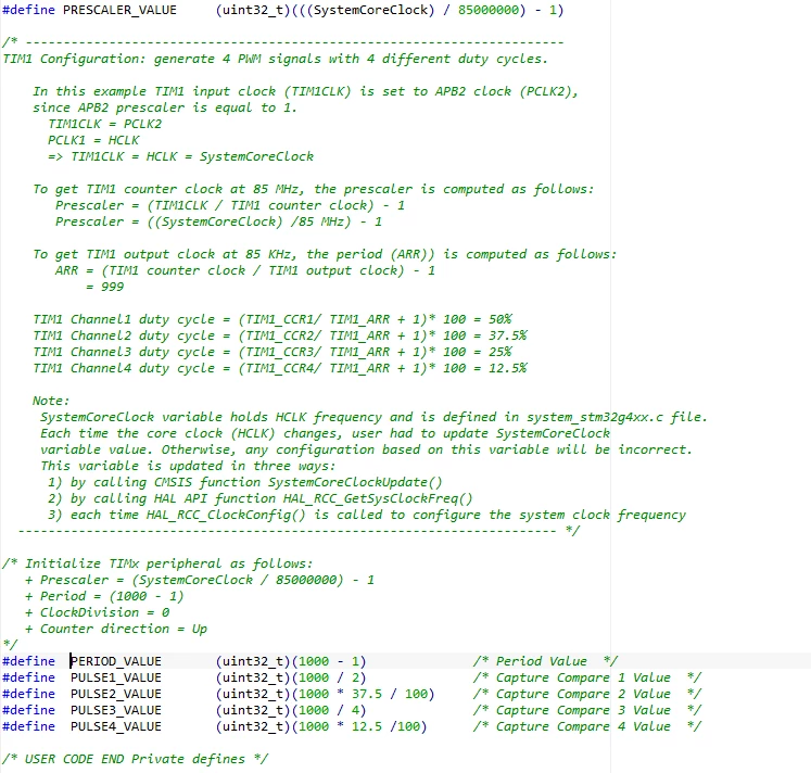

I use the PWM output example code of STM32CubeIDE,
how do I modify the duty cycle of the PWM, I can't find a way to modify it

Hello Jason,
You can simply change the PULSE_VALUE in the main.h
Regards,
Stassen

But I have a question,
I find this code but I can't understand how to change the PULSE_VALUE,
example code is output PWM has a 90% duty cycle, if change 50% duty cycle how to set the PULSE_VALUE?

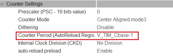

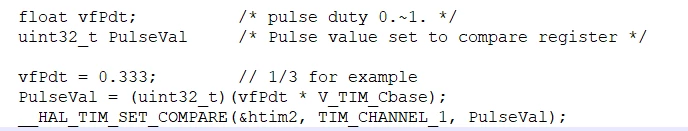

hello @Jason_fx
you can simply set "duty * counter-base-period" to "Compare Register" just like followings..
 where V_TIM_Cbase is defined in configration as below.
hope this could help
regards

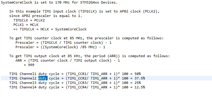

Sep 7, 2023 9:41 AM UTC
Hello @Jason_fx
TIMx channels duty cycle = (TIMx_CCR1/ (TIMx_ARR + 1))*100.
You can change the values off TIMx_CCR1 and TIMx_ARR to modify the duty cycle value.
Best regards.
