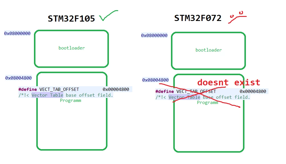

I developed my first canbus bootloader for a stm32f105.
Now im in need to use that same bootloader in a stm32f072.
The bootloader works but im unable to build a program that starts from a flash address other than 0x8000000.....
How are multi programm apps being programmes in stm32f0xx families?

waclawek.jan
June 22, 2021
There's no VTOR register in Cortex-M0.
You have to remap RAM to the 0x0000'0000 area (see SYSCFG_CFGR1.MEM_MODE), and copy the custom vector table (from the application's beginning) there.

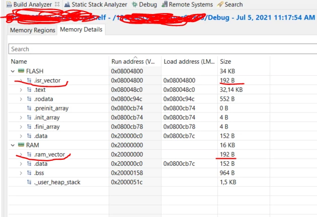

The name, "ram_vector" is a name arbitrarily chosen by me.
I need to tell the linker, "put my vector array as the first thing into RAM". So, in linker script, I insert those lines above anything else which would go into RAM.
Then, in program, I define the array as
> volatile uint32_t __attribute__((section(".ram_vector,\"aw\",%nobits @"))) ram_vector[VECTOR_TABLE_SIZE];
which tells the linker, that this variable should go to the .ram_vector section (the "\"aw\" etc. part... I honestly don't remember the exact reason, this is probably intended to prevent linker to put initialization values into FLASH; a similar effect should be achievable by tagging the .ram_vector as NOLOAD - usually there are several alternative ways to do things).

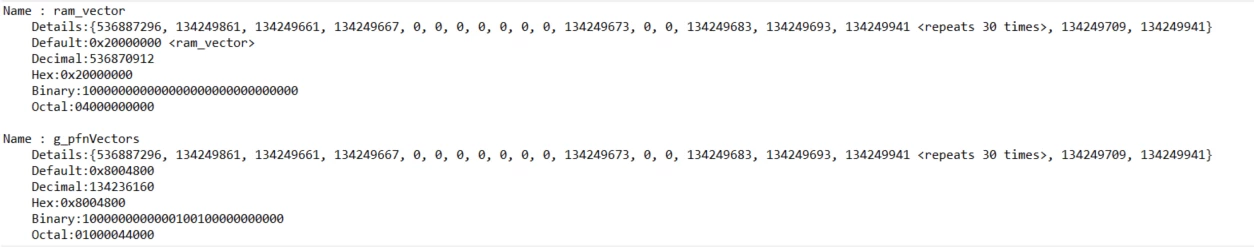

Okay i built the courage to give this another go and made it work.
 What i did ( following your steps @Community member​ :(
  • added all your defines and variables
/* USER CODE BEGIN PD */
 #define VECTOR_TABLE_SIZE (31 + 1 + 7 +9)//31 positive vectors, 0 vector, and 7 negative vectors (and extra 9 i dont know why)
 #define SYSCFG_CFGR1_MEM_MODE__MAIN_FLASH 0 // x0: Main Flash memory mapped at 0x0000 0000
 #define SYSCFG_CFGR1_MEM_MODE__SYSTEM_FLASH 1 // 01: System Flash memory mapped at 0x0000 0000
 #define SYSCFG_CFGR1_MEM_MODE__SRAM 3 // 11: Embedded SRAM mapped at 0x0000 0000
/* USER CODE END PD */
/* USER CODE BEGIN PV */

ram_vector looks like its corectly reserved by the linker at the beggining of ram0693W00000BcoAVQAZ.png
ram_vector also gets succesfully filled with the correct vectors
