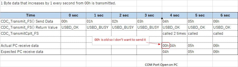

How to abort or timeout CDC_Transmit_FS
I am sending with CDC_Transmit_FS by USB CDC, but USB_TransmitCplt_Callback is not called unless the other computer receives it on the COM port.
How do I time out or abort a send?

Hello Walid ZRELLI (ST Employee),
CDC_Transmit_FS() has not modified the code generated by STM32CubeMx.
Sorry, ​USB_TransmitCplt_Callback () function was developed by me.
I am calling own USB_TransmitCplt_Callback () from CDC_TransmitCplt_FS() as shown below.
CDC_TransmitCplt_FS() is not called until the COM port is opened on the PC.
CDC_TransmitCplt_FS() is called when the COM port is opened on the PC.
I want to discard data that hasn't been sent for a period of time.
static int8_t CDC_TransmitCplt_FS(uint8_t *Buf, uint32_t *Len, uint8_t epnum)
 uint8_t result = USBD_OK;
 /* USER CODE BEGIN 13 */
 extern void USB_TransmitCplt_Callback(const uint8_t * Buf, const uint32_t * Len);
 USB_TransmitCplt_Callback(Buf, Len);
 /* USER CODE END 13 */
 return result;
Thank you for your kind cooperation.​
Thank you for reply.
I'm sorry I didn't explain it well.
The call to CDC_Transmit_FS () is completed immediately, so I don't think the above sample can solve it.
0693W00000CzwDNQAZ.pngThe problem is that the transmitted data remains in STM32L433 MCU forever until COM is opened on the PC side.
I will try to solve it on the PC side.
Thank you for cooperation.
